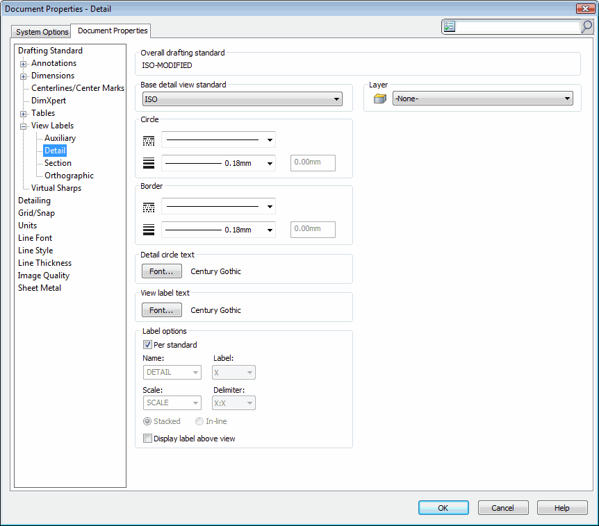

Document Properties > View Labels > Detail
Setting
Get/Set Methods
Return Value or <Value>
Comments
Base detail view standard
IModelDocExtension::GetUserPreferenceInteger(swUserPreferenceIntegerValue_e.swDetailingDimensionStandard, swUserPreferenceOption_e.swDetailingDetailView)
IModelDocExtension::SetUserPreferenceInteger(swUserPreferenceIntegerValue_e.swDetailingDimensionStandard, swUserPreferenceOption_e.swDetailingDetailView, swDetailingStandard_e.<Value>)
See swDetailingStandard_e for valid options
Specifies the base detail view standard to use
Circle - Line Style
IModelDocExtension::GetUserPreferenceInteger(swUserPreferenceIntegerValue_e.swLineFontDetailCircleStyle, swUserPreferenceOption_e.swDetailingNoOptionSpecified)
IModelDocExtension::SetUserPreferenceInteger(swUserPreferenceIntegerValue_e.swLineFontDetailCircleStyle, swUserPreferenceOption_e.swDetailingNoOptionSpecified, swLineStyles_e.<Value>)
See swLineStyles_e for valid options
Specifies the line style of detail view circles
Circle - Line Thickness
IModelDocExtension::GetUserPreferenceInteger(swUserPreferenceIntegerValue_e.swLineFontDetailCircleThickness, swUserPreferenceOption_e.swDetailingNoOptionSpecified)
IModelDocExtension::SetUserPreferenceInteger(swUserPreferenceIntegerValue_e.swLineFontDetailCircleThickness, swUserPreferenceOption_e.swDetailingNoOptionSpecified, swLineWeights_e.<Value>)
See swLineWeights_e for valid options
Specifies the line thickness of detail view circles
Circle - Custom thickness
IModelDocExtension::GetUserPreferenceDouble(swUserPreferenceDoubleValue_e.swLineFontDetailCircleThicknessCustom, swUserPreferenceOption_e.swDetailingNoOptionSpecified)
IModelDocExtension::SetUserPreferenceDouble(swUserPreferenceDoubleValue_e.swLineFontDetailCircleThicknessCustom, swUserPreferenceOption_e.swDetailingNoOptionSpecified, <Value>)
Double value
Specifies custom thickness of lines for detail view circles; sets Custom Thickness to the specified thickness and Leader Thickness to Custom Size
Border - Line Style
IModelDocExtension::GetUserPreferenceInteger(swUserPreferenceIntegerValue_e.swLineFontDetailBorderStyle, swUserPreferenceOption_e.swDetailingNoOptionSpecified)
IModelDocExtension::SetUserPreferenceInteger(swUserPreferenceIntegerValue_e.swLineFontDetailBorderStyle, swUserPreferenceOption_e.swDetailingNoOptionSpecified, swLineStyles_e.<Value>)
Specifies style of detail view border
Border - Line Thickness
IModelDocExtension::GetUserPreferenceInteger(swUserPreferenceIntegerValue_e.swLineFontDetailBorderThickness, swUserPreferenceOption_e.swDetailingNoOptionSpecified)
IModelDocExtension::SetUserPreferenceInteger(swUserPreferenceIntegerValue_e.swLineFontDetailBorderThickness, swUserPreferenceOption_e.swDetailingNoOptionSpecified, swLineWeights_e.<Value>)
Specifies thickness of detail view border
Border - Custom thickness
IModelDocExtension::GetUserPreferenceDouble(swUserPreferenceDoubleValue_e.swLineFontDetailBorderThicknessCustom, swUserPreferenceOption_e.swDetailingNoOptionSpecified)
IModelDocExtension::SetUserPreferenceDouble(swUserPreferenceDoubleValue_e.swLineFontDetailBorderThicknessCustom, swUserPreferenceOption_e.swDetailingNoOptionSpecified, <Value>)
Double value
Specifies custom thickness of detail view border lines; sets Custom Thickness to the specified thickness and Leader Thickness to Custom Size
Detail circle text - Font...
IModelDocExtension::GetUserPreferenceTextFormat(swUserPreferenceTextFormat_e.swDetailingDetailTextFormat, swUserPreferenceOption_e.swDetailingNoOptionSpecified)
IModelDocExtension::SetUserPreferenceTextFormat(swUserPreferenceTextFormat_e.swDetailingDetailTextFormat, swUserPreferenceOption_e.swDetailingNoOptionSpecified, <Value>)
See ITextFormat for font options
To set font property values, implement ITextFormat, set the appropriate ITextFormat member values, and pass the ITextFormat object in the API set method
View label text - Font...
IModelDocExtension::GetUserPreferenceTextFormat(swUserPreferenceTextFormat_e.swDetailingDetailLabelTextFormat, swUserPreferenceOption_e.swDetailingNoOptionSpecified)
IModelDocExtension::SetUserPreferenceTextFormat(swUserPreferenceTextFormat_e.swDetailingDetailLabelTextFormat, swUserPreferenceOption_e.swDetailingNoOptionSpecified, <Value>)
Label options - Per standard
IModelDocExtension::GetUserPreferenceToggle(swUserPreferenceToggle_e.swDetailingDetailViewLabels_PerStandard, swUserPreferenceOption_e.swDetailingNoOptionSpecified)
IModelDocExtension::SetUserPreferenceToggle(swUserPreferenceToggle_e.swDetailingDetailViewLabels_PerStandard, swUserPreferenceOption_e.swDetailingNoOptionSpecified, <Value>)
Boolean value
If...
Then display the detail view label according to the format...
True
Required by the current detailing standard
False
Determined by these document-level user preferences:
swDetailingDetailViewLabels_Name
swDetailingDetailViewLabels_Label
swDetailingDetailViewLabels_Scale
swDetailingDetailViewLabels_Delimiter
Label options - Name
IModelDocExtension::GetUserPreferenceInteger(swUserPreferenceIntegerValue_e.swDetailingDetailViewLabels_Name, swUserPreferenceOption_e.swDetailingNoOptionSpecified)
IModelDocExtension::SetUserPreferenceInteger(swUserPreferenceIntegerValue_e.swDetailingDetailViewLabels_Name, swUserPreferenceOption_e.swDetailingNoOptionSpecified, swDetailingViewLabelsName_e.<Value>)
See swDetailingViewLabelsName_e for valid options
Specifies the label to use in front of the detail view; if set to swDetailingViewLabelsName_e.swDetailingViewLabelsName_custom, then set Label options - Name (CUSTOM) to a custom label
IModelDocExtension::GetUserPreferenceString(swUserPreferenceStringValue_e.swDetailingDetailViewLabels_CustomName, swUserPreferenceOption_e.swDetailingDetailView)
IModelDocExtension::SetUserPreferenceString(swUserPreferenceStringValue_e.swDetailingDetailViewLabels_CustomName, swUserPreferenceOption_e.swDetailingDetailView, <Value>)
String value
Specifies the custom label to use in front of the detail view; valid only if Label options - Name is set to swDetailingViewLabelsName_e.swDetailingViewLabelsName_custom
Label options - Label
IModelDocExtension::GetUserPreferenceInteger(swUserPreferenceIntegerValue_e.swDetailingDetailViewLabels_Label, swUserPreferenceOption_e.swDetailingNoOptionSpecified)
IModelDocExtension::SetUserPreferenceInteger(swUserPreferenceIntegerValue_e.swDetailingDetailViewLabels_Label, swUserPreferenceOption_e.swDetailingNoOptionSpecified, swDetailingViewLabelsLabel_e.<Value>)
See swDetailingViewLabelsLabel_e for valid options
Specifies the format of the detail view label
Label options - Scale
IModelDocExtension::GetUserPreferenceInteger(swUserPreferenceIntegerValue_e.swDetailingDetailViewLabels_Scale, swUserPreferenceOption_e.swDetailingNoOptionSpecified)
IModelDocExtension::SetUserPreferenceInteger(swUserPreferenceIntegerValue_e.swDetailingDetailViewLabels_Scale, swUserPreferenceOption_e.swDetailingNoOptionSpecified, swDetailingViewLabelsScale_e.<Value>)
See swDetailingViewLabelsScale_e for valid options
Specifies the label to use in front of the scale value; if set to swDetailingViewLabelsScale_e.swDetailingViewLabelsScale_SCALEcustom, then set Label options - Scale (CUSTOM) to a custom label
IModelDocExtension::GetUserPreferenceString(swUserPreferenceStringValue_e.swDetailingDetailViewLabels_CustomScale, swUserPreferenceOption_e.swDetailingDetailView)
IModelDocExtension::SetUserPreferenceString(swUserPreferenceStringValue_e.swDetailingDetailViewLabels_CustomScale, swUserPreferenceOption_e.swDetailingDetailView, <Value>)
String value
Specifies the custom label to use in front of the scale value; valid only if Label options - Scale is set to swDetailingViewLabelsScale_e.swDetailingViewLabelsScale_SCALEcustom
Label options - Delimiter
IModelDocExtension::GetUserPreferenceInteger(swUserPreferenceIntegerValue_e.swDetailingDetailViewLabels_Delimiter, swUserPreferenceOption_e.swDetailingNoOptionSpecified)
IModelDocExtension::SetUserPreferenceInteger(swUserPreferenceIntegerValue_e.swDetailingDetailViewLabels_Delimiter, swUserPreferenceOption_e.swDetailingNoOptionSpecified, swDetailingViewLabelsDelimiter_e .<Value>)
See swDetailingViewLabelsDelimiter_e for valid options
Specifies the format of the scale value
Stacked or In-line
IModelDocExtension::GetUserPreferenceToggle(swUserPreferenceToggle_e.swDetailingDetailViewLabels_Stacked, swUserPreferenceOption_e.swDetailingNoOptionSpecified)
IModelDocExtension::SetUserPreferenceToggle(swUserPreferenceToggle_e.swDetailingDetailViewLabels_Stacked, swUserPreferenceOption_e.swDetailingNoOptionSpecified, <Value>)
Boolean value
If...
Then display the detail view name and scale in...
True
2 lines
False
1 line
Label options - Display label above view
IModelDocExtension::GetUserPreferenceToggle(swUserPreferenceToggle_e.swDetailingDetailViewLabels_AboveView, swUserPreferenceOption_e.swDetailingNoOptionSpecified)
IModelDocExtension::SetUserPreferenceToggle(swUserPreferenceToggle_e.swDetailingDetailViewLabels_AboveView, swUserPreferenceOption_e.swDetailingNoOptionSpecified, <Value>)
Boolean value
Specifies whether to show label above detail view
Layer
IModelDocExtension::GetUserPreferenceString(swUserPreferenceStringValue_e.swDetailingLayer, swUserPreferenceOption_e.swDetailingDetailView)
IModelDocExtension::SetUserPreferenceString(swUserPreferenceStringValue_e.swDetailingLayer, swUserPreferenceOption_e.swDetailingDetailView, <Value>)
Valid Options:
  • "Border"
  • "Dimensions"
  • "Notes"
  • "BOM"
  • "FORMAT"
This setting is available only on drawings; depending on drawing, some options may not apply
