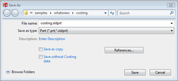

File > Save As
Setting
Get/Set Methods
Return Value
or
<Value>
or
<OnFlag>
Comment

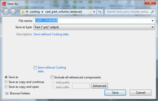

Save without Costing data
IModelDocExtension::GetUserPreferenceToggle(swUserPreferenceToggle_e.swSaveWithoutCostingData)
IModelDocExtension::SetUserPreferenceToggle(swUserPreferenceToggle_e.swSaveWithoutCostingData, <OnFlag>)
Boolean value
Specifies whether to save the sheet metal part without including any Costing data
