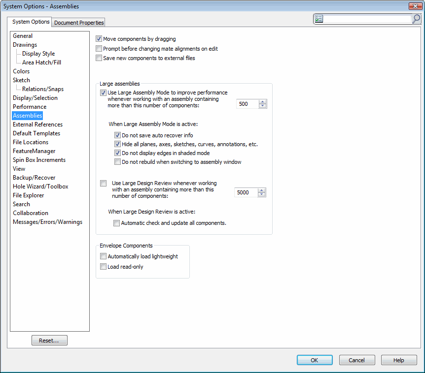

System Options > Assemblies
Setting
Get/Set Method
Return Value
or
<Value>
or
<OnFlag>
Comment
Move components by dragging
ISldWorks::GetUserPreferenceToggle(swUserPreferenceToggle_e.swAssemblyAllowComponentMoveByDragging)
ISldWorks::SetUserPreferenceToggle(swUserPreferenceToggle_e.swAssemblyAllowComponentMoveByDragging, <OnFlag>)
Boolean value
Specifies whether to move assembly components by dragging them or using the Move with Triad and Move Component tools
Prompt before changing mate alignments on edit
ISldWorks::GetUserPreferenceToggle(swUserPreferenceToggle_e.swPromptForAutoMateFlip)
ISldWorks::SetUserPreferenceToggle(swUserPreferenceToggle_e.swPromptForAutoMateFlip, <OnFlag>)
Boolean value
Specifies whether to prompt before automatically flipping a mate to avoid errors
Save new components to external files
ISldWorks::GetUserPreferenceToggle(swUserPreferenceToggle_e.swSaveNewComponentToExternalFile)
ISldWorks::SetUserPreferenceToggle(swUserPreferenceToggle_e.swSaveNewComponentToExternalFile, <OnFlag>)
Boolean value
Specifies whether to save new components to external files
Large assemblies - Use Large Assembly Mode to improve performance whenever working with an assembly containing more than this number of components (checkbox)
ISldWorks::GetUserPreferenceToggle(swUserPreferenceToggle_e.swLargeAsmModeEnabled)
ISldWorks::SetUserPreferenceToggle(swUserPreferenceToggle_e.swLargeAsmModeEnabled, <OnFlag>)
Boolean value
Specifies whether to activate large assembly mode
Large assemblies - Use Large Assembly Mode to improve performance whenever working with an assembly containing more than this number of components (listbox)
ISldWorks::GetUserPreferenceIntegerValue(swUserPreferenceIntegerValue_e.swLargeAsmModeThreshold)
ISldWorks::SetUserPreferenceIntegerValue(swUserPreferenceIntegerValue_e.swLargeAsmModeThreshold, <Value>)
Integer value
Large assemblies - When Large Assembly Mode is active - Do not save auto recover info
ISldWorks::GetUserPreferenceToggle(swUserPreferenceToggle_e.swLargeAsmModeAutoRecover)
ISldWorks::SetUserPreferenceToggle(swUserPreferenceToggle_e.swLargeAsmModeAutoRecover, <OnFlag>)
Boolean value
Specifies whether to automatically save model information after specified number of changes
Large assemblies - When Large Assembly Mode is active - Hide all planes, axes, sketches, curves, annotations, etc.
ISldWorks::GetUserPreferenceToggle(swUserPreferenceToggle_e.swLargeAsmModeHideAllItems)
ISldWorks::SetUserPreferenceToggle(swUserPreferenceToggle_e.swLargeAsmModeHideAllItems, <OnFlag>)
Boolean value
Specifies whether to hide all planes, axes, sketches, curves, annotations, etc.
Large assemblies - When Large Assembly Mode is active - Do not display edges in shaded mode
ISldWorks::GetUserPreferenceToggle(swUserPreferenceToggle_e.swLargeAsmModeUseHLREdgesInShaded)
ISldWorks::SetUserPreferenceToggle(swUserPreferenceToggle_e.swLargeAsmModeUseHLREdgesInShaded, <OnFlag>)
Boolean value
Specifies whether to use HLR edges in shaded mode
Large assemblies - When Large Assembly Mode is active - Do not rebuild when switching to assembly window
ISldWorks::GetUserPreferenceToggle(swUserPreferenceToggle_e.swLargeAsmModeDismissAutoUpdate)
ISldWorks::SetUserPreferenceToggle(swUserPreferenceToggle_e.swLargeAsmModeDismissAutoUpdate, <OnFlag>)
Boolean value
Specifies whether to rebuild when switching to the assembly window
Large assemblies - Use Large Design Review whenever working with an assembly containing more than this number of components
ISldWorks::GetUserPreferenceToggle(swUserPreferenceToggle_e.swLargeAsmModeLargeDesignReview)
ISldWorks::SetUserPreferenceToggle(swUserPreferenceToggle_e.swLargeAsmModeLargeDesignReview, <OnFlag>)
ISldWorks::GetUserPreferenceIntegerValue(swUserPreferenceIntegerValue_e.swLargeAsmModeLargeDesignReviewThreshhold)
ISldWorks::SetUserPreferenceIntegerValue(swUserPreferenceIntegerValue_e.swLargeAsmModeLargeDesignReviewThreshhold, <Value>)
Boolean value
Integer value
Specifies whether to automatically use Large Design Review based on the number of components in the assembly; see swLargeAsmModeLargeDesignReviewThreshhold
Specifies the minimum number of components in an assembly for automatically using Large Design Review
Large assemblies - When Large Design Review is active: - Automatic check and update all components
ISldWorks::GetUserPreferenceToggle(swUserPreferenceToggle_e.swLargeAsmModeAutoCheckUpdateAllComponents)
ISldWorks::SetUserPreferenceToggle(swUserPreferenceToggle_e.swLargeAsmModeAutoCheckUpdateAllComponents, <OnFlag>)
Boolean value
Specifies whether to automatically check and update all components when Large Design Review is active
Envelope Components - Automatically load lightweight
ISldWorks::GetUserPreferenceToggle(swUserPreferenceToggle_e.swLoadEnvelopeLightweight)
ISldWorks::SetUserPreferenceToggle(swUserPreferenceToggle_e.swLoadEnvelopeLightweight, <OnFlag>)
Boolean value
Specifies whether to automatically load envelope components in lightweight mode
Envelope Components - Load read-only
ISldWorks::GetUserPreferenceToggle(swUserPreferenceToggle_e.swLoadEnvelopeReadOnly)
ISldWorks::SetUserPreferenceToggle(swUserPreferenceToggle_e.swLoadEnvelopeReadOnly, <OnFlag>)
Boolean value
Specifies whether to load envelope components in read-only mode
