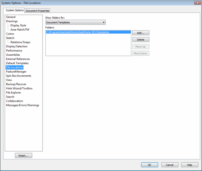

System Options > File Locations
This topic contains two tables. The information in the table:
  • appearing immediately after the screen capture of the System Options - File Locations dialog corresponds to the settings on that dialog.
  • titled Obsolete Enumerators contains enumerators that previously appeared on the System Options - File Locations dialog, but are now obsolete and no longer appear on that dialog.
Setting
Get/Set Methods
Return Value
or
<Value>
Comment

ISldWorks::GetUserPreferenceStringValue(swUserPreferenceStringValue_e.swFileLocationsWeldmentPropertyFile)
ISldWorks::SetUserPreferenceStringValue(swUserPreferenceStringValue_e.swFileLocationsWeldmentPropertyFile, <Value>)
String value
Show folders for - 3D ContentCentral Model Download Folder - Folders
ISldWorks::GetUserPreferenceStringValue(swUserPreferenceStringValue_e.swFileLocations3DCCModelFolder)
ISldWorks::SetUserPreferenceStringValue(swUserPreferenceStringValue_e.swFileLocations3DCCModelFolder, <Value>)
String value
Show folders for - 3D PDF Themes - Folders
ISldWorks::GetUserPreferenceStringValue(swUserPreferenceStringValue_e.swFileLocationsThemeFolder)
ISldWorks::SetUserPreferenceStringValue(swUserPreferenceStringValue_e.swFileLocationsThemeFolder, <Value>)
String value
Show folders for - Sustainability Report Template Folder
ISldWorks::GetUserPreferenceStringValue(swUserPreferenceStringValue_e.swFileLocationsSustainabilityReportTemplateFolder)
ISldWorks::SetUserPreferenceStringValue(swUserPreferenceStringValue_e.swFileLocationsSustainabilityReportTemplateFolder, <Value>)
String value
Show folders for - Costing Report Template Folder
ISldWorks::GetUserPreferenceStringValue(swUserPreferenceStringValue_e.swFileLocationsCostingReportTemplateFolder)
ISldWorks::SetUserPreferenceStringValue(swUserPreferenceStringValue_e.swFileLocationsCostingReportTemplateFolder, <Value>)
String value
Show folders for - Costing templates
ISldWorks::GetUserPreferenceStringValue(swUserPreferenceStringValue_e.swFileLocationsCostingTemplates)
ISldWorks::SetUserPreferenceStringValue(swUserPreferenceStringValue_e.swFileLocationsCostingTemplates, <Value>)
String value
Show folders for - Weld Table Template
ISldWorks::GetUserPreferenceStringValue(swUserPreferenceStringValue_e.swFileLocationsWeldTableTemplate)
ISldWorks::SetUserPreferenceStringValue(swUserPreferenceStringValue_e.swFileLocationsWeldTableTemplate, <Value>)
String value
Show folders for - Bend Table Template
ISldWorks::GetUserPreferenceStringValue(swUserPreferenceStringValue_e.swFileLocationsBendTableTemplate)
ISldWorks::SetUserPreferenceStringValue(swUserPreferenceStringValue_e.swFileLocationsBendTableTemplate, <Value>)
String value
Show folders for - Punch Table Template
ISldWorks::GetUserPreferenceStringValue(swUserPreferenceStringValue_e.swFileLocationsPunchTableTemplate)
ISldWorks::SetUserPreferenceStringValue(swUserPreferenceStringValue_e.swFileLocationsPunchTableTemplate, <Value>)
String value
