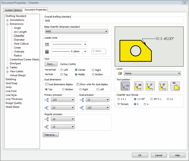

Document Properties > Dimensions > Chamfer
Setting
Get/Set Methods
Return Value or <Value>
Comments
Base chamfer dimension standard
IModelDocExtension::GetUserPreferenceInteger(swUserPreferenceIntegerValue_e.swDetailingDimensionStandard, swUserPreferenceOption_e.swDetailingChamferDimension)
IModelDocExtension::SetUserPreferenceInteger(swUserPreferenceIntegerValue_e.swDetailingDimensionStandard, swUserPreferenceOption_e.swDetailingChamferDimension, swDetailingStandard_e.<Value>)
See swDetailingStandard_e for valid options
Specifies the base chamfer dimensioning standard to use
Leader style - Leader Style
IModelDocExtension::GetUserPreferenceInteger(swUserPreferenceIntegerValue_e.swLineFontDimensionsStyle, swUserPreferenceOption_e.swDetailingChamferDimension)
IModelDocExtension::SetUserPreferenceInteger(swUserPreferenceIntegerValue_e.swLineFontDimensionsStyle, swUserPreferenceOption_e.swDetailingChamferDimension, swLineStyles_e.<Value>)
See swLineStyles_e for valid options
Specifies style of lines for chamfer dimensions
Leader style - Leader Thickness
IModelDocExtension::GetUserPreferenceInteger(swUserPreferenceIntegerValue_e.swLineFontDimensionsThickness, swUserPreferenceOption_e.swDetailingChamferDimension)
IModelDocExtension::SetUserPreferenceInteger(swUserPreferenceIntegerValue_e.swLineFontDimensionsThickness, swUserPreferenceOption_e.swDetailingChamferDimension, swLineWeights_e.<Value>)
See swLineWeights_e for valid options
Specifies thickness of lines for chamfer dimensions
Leader style - Custom Thickness
IModelDocExtension::GetUserPreferenceDouble(swUserPreferenceDoubleValue_e.swLineFontDimensionsThicknessCustom, swUserPreferenceOption_e.swDetailingChamferDimension)
IModelDocExtension::SetUserPreferenceDouble(swUserPreferenceDoubleValue_e.swLineFontDimensionsThicknessCustom, swUserPreferenceOption_e.swDetailingChamferDimension, <Value>)
Double value
Specifies a custom thickness for lines in chamfer dimensions; sets Custom Thickness to the specified thickness and Leader Thickness to Custom Size
Text - Font...
IModelDocExtension::GetUserPreferenceTextFormat(swUserPreferenceTextFormat_e.swDetailingDimensionTextFormat, swUserPreferenceOption_e.swDetailingChamferDimension)
IModelDocExtension::SetUserPreferenceTextFormat(swUserPreferenceTextFormat_e.swDetailingDimensionTextFormat, swUserPreferenceOption_e.swDetailingChamferDimension, <Value>)
See ITextFormat for font options
To set font property values, implement ITextFormat, set the appropriate ITextFormat member values, and pass the ITextFormat object in the API set method
Text - Horizontal
IModelDocExtension::GetUserPreferenceInteger(swUserPreferenceIntegerValue_e.swDetailingDimensionTextAlignmentHorizontal, swUserPreferenceOption_e.swDetailingChamferDimension)
IModelDocExtension::SetUserPreferenceInteger(swUserPreferenceIntegerValue_e.swDetailingDimensionTextAlignmentHorizontal, swUserPreferenceOption_e.swDetailingChamferDimension, swTextJustification_e.<Value>)
See swTextJustification_e for valid options
Text - Vertical
IModelDocExtension::GetUserPreferenceInteger(swUserPreferenceIntegerValue_e.swDetailingDimensionTextAlignmentVertical, swUserPreferenceOption_e.swDetailingChamferDimension)
IModelDocExtension::SetUserPreferenceInteger(swUserPreferenceIntegerValue_e.swDetailingDimensionTextAlignmentVertical, swUserPreferenceOption_e.swDetailingChamferDimension, swTextAlignmentVertical_e.<Value>)
See swTextAlignmentVertical_e for valid options
Dual dimensions - Dual dimensions display
IModelDocExtension::GetUserPreferenceToggle(swUserPreferenceToggle_e.swDetailingDualDimensions, swUserPreferenceOption_e.swDetailingChamferDimension)
IModelDocExtension::SetUserPreferenceToggle(swUserPreferenceToggle_e.swDetailingDualDimensions, swUserPreferenceOption_e.swDetailingChamferDimension, <Value>)
Boolean value
Specifies whether to display units for dual dimensions
Dual dimensions - Dimension position
IModelDocExtension::GetUserPreferenceInteger(swUserPreferenceIntegerValue_e.swDetailingDualDimPosition, swUserPreferenceOption_e.swDetailingChamferDimension)
IModelDocExtension::SetUserPreferenceInteger(swUserPreferenceIntegerValue_e.swDetailingDualDimPosition, swUserPreferenceOption_e.swDetailingChamferDimension, swDetailingDualDimPosition_e.<Value>)
See swDetailingDualDimPosition_e for valid options
Positions the display of dimensions in two kinds of units
Primary precision - Unit Precision
IModelDocExtension::GetUserPreferenceInteger(swUserPreferenceIntegerValue_e.swDetailingLinearDimPrecision, swUserPreferenceOption_e.swDetailingChamferDimension)
IModelDocExtension::SetUserPreferenceInteger(swUserPreferenceIntegerValue_e.swDetailingLinearDimPrecision, swUserPreferenceOption_e.swDetailingChamferDimension, <Value>)
Number of decimal places to display; 0 through 8
Specifies primary precision for linear dimension
Primary precision - Tolerance Precision
IModelDocExtension::GetUserPreferenceInteger(swUserPreferenceIntegerValue_e.swDetailingLinearTolPrecision, swUserPreferenceOption_e.swDetailingChamferDimension)
IModelDocExtension::SetUserPreferenceInteger(swUserPreferenceIntegerValue_e.swDetailingLinearTolPrecision, swUserPreferenceOption_e.swDetailingChamferDimension, swDimensionPrecisionSettings_e .<Value>)
See swDimensionPrecisionSettings_e for valid options
Specifies primary precision for tolerance
Dual precision - Unit Precision
IModelDocExtension::GetUserPreferenceInteger(swUserPreferenceIntegerValue_e.swDetailingAltLinearDimPrecision, swUserPreferenceOption_e.swDetailingChamferDimension)
IModelDocExtension::SetUserPreferenceInteger(swUserPreferenceIntegerValue_e.swDetailingAltLinearDimPrecision, swUserPreferenceOption_e.swDetailingChamferDimension, <Value>)
Specifies dual precision for alternate linear dimension
Dual precision - Tolerance Precision
IModelDocExtension::GetUserPreferenceInteger(swUserPreferenceIntegerValue_e.swDetailingAltLinearTolPrecision, swUserPreferenceOption_e.swDetailingChamferDimension)
IModelDocExtension::SetUserPreferenceInteger(swUserPreferenceIntegerValue_e.swDetailingAltLinearTolPrecision, swUserPreferenceOption_e.swDetailingChamferDimension, swDimensionPrecisionSettings_e .<Value>)
Specifies dual precision for alternate linear tolerance
Angular precision - Unit Precision
IModelDocExtension::GetUserPreferenceInteger(swUserPreferenceIntegerValue_e.swDetailingAngularDimPrecision, swUserPreferenceOption_e.swDetailingChamferDimension)
IModelDocExtension::SetUserPreferenceInteger(swUserPreferenceIntegerValue_e.swDetailingAngularDimPrecision, swUserPreferenceOption_e.swDetailingChamferDimension, <Value>)
Specifies integer value for angular precision
Angular precision - Tolerance Precision
IModelDocExtension::GetUserPreferenceInteger(swUserPreferenceIntegerValue_e.swDetailingAngularTolPrecision, swUserPreferenceOption_e.swDetailingChamferDimension)
IModelDocExtension::SetUserPreferenceInteger(swUserPreferenceIntegerValue_e.swDetailingAngularTolPrecision, swUserPreferenceOption_e.swDetailingChamferDimension, swDimensionPrecisionSettings_e .<Value>)
Specifies integer value for tolerance marg08precision
Tolerance...
See Comments
See Comments
See Dimension Tolerance
Layer
IModelDocExtension::GetUserPreferenceString(swUserPreferenceStringValue_e.swDetailingLayer, swUserPreferenceOption_e.swDetailingChamferDimension)
IModelDocExtension::SetUserPreferenceString(swUserPreferenceStringValue_e.swDetailingLayer, swUserPreferenceOption_e.swDetailingChamferDimension, <Value>)
Valid Options:
  • "Border"
  • "Dimensions"
  • "Notes"
  • "BOM"
  • "FORMAT"
This setting is available only on drawings; depending on drawing, some options may not apply
Text position
IModelDocExtension::GetUserPreferenceInteger(swUserPreferenceIntegerValue_e.swDetailingDimensionTextAndLeaderStyle, swUserPreferenceOption_e.swDetailingChamferDimension)
IModelDocExtension::SetUserPreferenceInteger(swUserPreferenceIntegerValue_e.swDetailingDimensionTextAndLeaderStyle, swUserPreferenceOption_e.swDetailingChamferDimension, swDetailingChamferDimLeaderStyle_e.<Value>)
See swDetailingChamferDimLeaderStyle_e for valid options
Specifies how to display leader
Chamfer text format - "X" format
IModelDocExtension::GetUserPreferenceInteger(swUserPreferenceIntegerValue_e.swDetailingChamferDimXStyle, swUserPreferenceOption_e.swDetailingNoOptionSpecified)
IModelDocExtension::SetUserPreferenceInteger(swUserPreferenceIntegerValue_e.swDetailingChamferDimXStyle, swUserPreferenceOption_e.swDetailingNoOptionSpecified, swDetailingChamferDimXStyle_e.<Value>)
See swDetailingChamferDimXStyle_e for valid options
