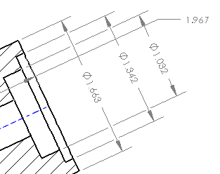

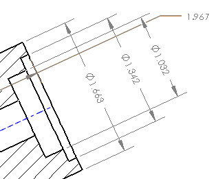

In linear and radial dimensions, you can control which elements of a dimension break around other dimensional elements. On the Leaders tab of the respective PropertyManager, under Break Lines:
  • Select Break extension lines to break extension lines around dimension lines and other extension lines.
  • Select Break dimension line to break the dimension line around other dimension lines and other extension lines.

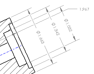

In Tools > Options > Document Properties > Dimensions, the Break only around dimension arrows option still limits breaks to be around dimension arrows only when you select either of the above options.

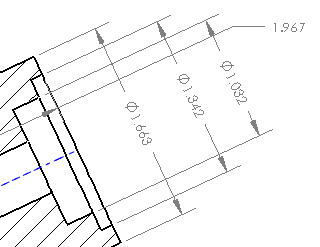

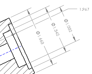

Break Both Extension Lines and Dimension Lines wn-both-dim-ext-line-breaks.png
