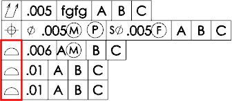

The Geometric Tolerance (GD&T) dialog box supports changes specified in the ASME Y14.5-2009 standards.
Using the Geometric Tolerance dialog box:
  • You can combine multiple adjacent rows with the same geometric symbols into a single composite frame.
    Drawing_Geometric_tolerance
    Drawing_Geometric_Tolerance2
  • You can insert the symbol for Translation at the end of a selected field.
    If you add other symbols, the Translation geometric_tolerance_translation.PNGsymbol appears after them in the field.
