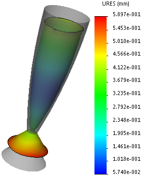

After the analysis completes, you can plot the final residual stresses and displacements of the part after it is completely cooled.
The final shape of the part (at pseudo time t = 1 sec) considers the effect of both the in-mold stresses (at pseudo time t = 0) and quenching thermal stresses.
To view the final shape of the part:
- Under Results, open the Displacement Plot PropertyManager.
- Set Time to 1 sec and select Automatic under Deformed Shape.
- In the Settings tab, select Superimpose model on the deformed shape.
- Click OK.
