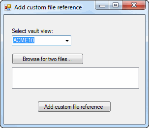

' Postconditions:
' 1. Displays the Add custom file reference dialog box.
'    a. Select a vault view.
'    b. Click Browse for two files
'       1. Locate and click two files in the root folder of the vault.
'       2. Click Open.
'          The first file is checked out.
'    c. Click Add custom file reference.
'       Displays a message box confirming that the second file is added as a
'       custom reference to the first file.
'    d. Click OK.
'       Displays a message box with all of the custom file references of the first
'       file.
'    e. Click OK.
' 2. Close the Add custom file reference dialog.

        Me.BrowseButton.Text = "Browse for two files..."

        Me.AddCustomFileReference.Text = "Add custom file reference"

        Me.Text = "Add custom file reference"
