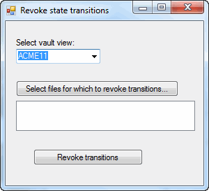

// Postconditions:
//  1. The Revoke state transitions dialog box displays.
//     a. Select a vault view.
//     b. Click Select files for which to revoke transitions.
//     c. In the Select File dialog:
//        1. Select a file that transitioned to the Approved state using the
//           No Approval Required transition.
//        2. Click Open.
//  2. Click Revoke transitions.
//  3. Click OK in the Revoke Transition dialog box.
//     The selected file's No Approval Required transition is revoked.
//  4. Close the Revoke state transitions dialog box.

        private void InitializeComponent()
            this.VaultsLabel = new System.Windows.Forms.Label();
            this.VaultsComboBox = new System.Windows.Forms.ComboBox();
            this.SelectFiles = new System.Windows.Forms.Button();
            this.File1List = new System.Windows.Forms.ListBox();
            this.RevokeTransitions = new System.Windows.Forms.Button();
            this.OpenFileDialog1 = new System.Windows.Forms.OpenFileDialog();
            this.SuspendLayout();
            //VaultsLabel
            this.VaultsLabel.AutoSize = true;
            this.VaultsLabel.Location = new System.Drawing.Point(12, 24);
            this.VaultsLabel.Name = "VaultsLabel";
            this.VaultsLabel.Size = new System.Drawing.Size(91, 13);
            this.VaultsLabel.TabIndex = 0;
            this.VaultsLabel.Text = "Select vault view:";
            //VaultsComboBox
            this.VaultsComboBox.FormattingEnabled = true;
            this.VaultsComboBox.Location = new System.Drawing.Point(15, 40);
            this.VaultsComboBox.Name = "VaultsComboBox";
            this.VaultsComboBox.Size = new System.Drawing.Size(121, 21);
            this.VaultsComboBox.TabIndex = 1;
            //SelectFiles
            this.SelectFiles.Location = new System.Drawing.Point(15, 85);
            this.SelectFiles.Name = "SelectFiles";
            this.SelectFiles.Size = new System.Drawing.Size(233, 23);
            this.SelectFiles.TabIndex = 2;
            this.SelectFiles.Text = "Select files for which to revoke transitions...";
            this.SelectFiles.UseVisualStyleBackColor = true;
            this.SelectFiles.Click +=new System.EventHandler(SelectFiles_Click);
            //File1List
            this.File1List.FormattingEnabled = true;
            this.File1List.HorizontalScrollbar = true;
            this.File1List.Location = new System.Drawing.Point(15, 114);
            this.File1List.Name = "File1List";
            this.File1List.SelectionMode = System.Windows.Forms.SelectionMode.MultiExtended;
            this.File1List.Size = new System.Drawing.Size(257, 43);
            this.File1List.TabIndex = 4;
            //RevokeTransitions
            this.RevokeTransitions.Location = new System.Drawing.Point(40, 183);
            this.RevokeTransitions.Name = "RevokeTransitions";
            this.RevokeTransitions.Size = new System.Drawing.Size(157, 23);
            this.RevokeTransitions.TabIndex = 6;
            this.RevokeTransitions.Text = "Revoke transitions";
            this.RevokeTransitions.UseVisualStyleBackColor = true;
            this.RevokeTransitions.Click +=new System.EventHandler(RevokeTransitions_Click);
            //OpenFileDialog1
            this.OpenFileDialog1.FileName = "OpenFileDialog1";
            this.OpenFileDialog1.Multiselect = false;
            this.OpenFileDialog1.Title = "Select File";
            //Form1
            this.AutoScaleDimensions = new System.Drawing.SizeF(6f, 13f);
            this.AutoScaleMode = System.Windows.Forms.AutoScaleMode.Font;
            this.ClientSize = new System.Drawing.Size(284, 235);
            this.Controls.Add(this.RevokeTransitions);
            this.Controls.Add(this.File1List);
            this.Controls.Add(this.SelectFiles);
            this.Controls.Add(this.VaultsComboBox);
            this.Controls.Add(this.VaultsLabel);
            this.Name = "Form1";
            this.Text = "Revoke state transitions";
            this.Load += new System.EventHandler(this.Form1_Load);
            this.ResumeLayout(false);
            this.PerformLayout();
        #endregion
