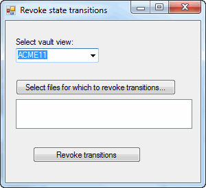

' Postconditions:
'  1. The Revoke state transitions dialog box displays.
'     a. Select a vault view.
'     b. Click Select files for which to revoke transitions.
'     c. In the Select File dialog:
'        1. Select a file that transitioned to the Approved state using the
'           No Approval Required transition.
'        2. Click Open.
'  2. Click Revoke transitions.
'  3. Click OK in the Revoke Transition dialog box.
'     The selected file's No Approval Required transition is revoked.
'  4. Close the Revoke state transitions dialog box.

        Me.Text = "Revoke state transitions"
