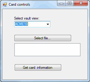

// Postconditions:
//  1. Displays a dialog.
//  2. Select a vault.
//  3. Click Select file.
//  4. In the Select File dialog:
//     a. Click a file in the vault.
//     b. Click Open.
//  5. Click Get card information.
//  6. A message box displays information about the selected file's data card.
//  7. Click OK in the message box.
// 8. A message box displays information about each edit box control in the
//     data card.
//  9. Click OK in the message boxes.
// 10. Close the dialog.

            this.Text = "Card controls";
