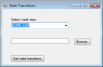

' Postconditions:
'  1. Displays the State Transitions dialog box.
'  2. Select a vault view.
'  3. Click Browse.
'  4. Displays the Select a file dialog box.
'     a. Click a file in the selected vault.
'     b. Click Open.
'     The selected file's path and file name appear
'     in the Select a file dialog box.
'  5. Click Get state transitions
'  6. Displays a message box showing the name of the selected
'     file and its current and next possible state transitions.
'  7. Click OK to close the message box.
'  8. Close the State Transitions dialog box.

'Form1.Designer.vb
<Global.Microsoft.VisualBasic.CompilerServices.DesignerGenerated()> _
Partial Class Form1
    Inherits System.Windows.Forms.Form
    'Form overrides dispose to clean up the component list.
    <System.Diagnostics.DebuggerNonUserCode()> _
    Protected Overrides Sub Dispose(ByVal disposing As Boolean)
        Try
            If disposing AndAlso components IsNot Nothing Then
                components.Dispose()
            End If
        Finally
            MyBase.Dispose(disposing)
        End Try
    End Sub
    'Required by the Windows Form Designer
    Private components As System.ComponentModel.IContainer
    'NOTE: The following procedure is required by the Windows Form Designer
    'It can be modified using the Windows Form Designer.
    'Do not modify it using the code editor.
    <System.Diagnostics.DebuggerStepThrough()> _
    Private Sub InitializeComponent()
        Me.VaultsLabel = New System.Windows.Forms.Label()
        Me.VaultsComboBox = New System.Windows.Forms.ComboBox()
        Me.FileListBox = New System.Windows.Forms.ListBox()
        Me.OpenFileDialog1 = New System.Windows.Forms.OpenFileDialog()
        Me.BrowseButton = New System.Windows.Forms.Button()
        Me.GetTransitionButton = New System.Windows.Forms.Button()
        Me.SuspendLayout()
        'VaultsLabel
        Me.VaultsLabel.AutoSize = True
        Me.VaultsLabel.ImageAlign = System.Drawing.ContentAlignment.MiddleLeft
        Me.VaultsLabel.Location = New System.Drawing.Point(25, 28)
        Me.VaultsLabel.Name = "VaultsLabel"
        Me.VaultsLabel.Size = New System.Drawing.Size(91, 13)
        Me.VaultsLabel.TabIndex = 0
        Me.VaultsLabel.Text = "Select vault view:"
        'VaultsComboBox
        Me.VaultsComboBox.FormattingEnabled = True
        Me.VaultsComboBox.Location = New System.Drawing.Point(28, 44)
        Me.VaultsComboBox.Name = "VaultsComboBox"
        Me.VaultsComboBox.Size = New System.Drawing.Size(190, 21)
        Me.VaultsComboBox.TabIndex = 1
        'FileListBox
        Me.FileListBox.FormattingEnabled = True
        Me.FileListBox.Location = New System.Drawing.Point(28, 97)
        Me.FileListBox.Name = "FileListBox"
        Me.FileListBox.Size = New System.Drawing.Size(190, 17)
        Me.FileListBox.TabIndex = 3
        'OpenFileDialog1
        Me.OpenFileDialog1.FileName = "OpenFileDialog1"
        Me.OpenFileDialog1.Multiselect = True
        Me.OpenFileDialog1.Title = "Select a file"
        'BrowseButton
        Me.BrowseButton.Location = New System.Drawing.Point(236, 97)
        Me.BrowseButton.Name = "BrowseButton"
        Me.BrowseButton.Size = New System.Drawing.Size(56, 23)
        Me.BrowseButton.TabIndex = 4
        Me.BrowseButton.Text = "Browse..."
        Me.BrowseButton.TextAlign = System.Drawing.ContentAlignment.MiddleLeft
        Me.BrowseButton.UseVisualStyleBackColor = True
        'GetTransitionButton
        Me.GetTransitionButton.ImageAlign = System.Drawing.ContentAlignment.MiddleLeft
        Me.GetTransitionButton.Location = New System.Drawing.Point(28, 152)
        Me.GetTransitionButton.Name = "GetTransitionButton"
        Me.GetTransitionButton.Size = New System.Drawing.Size(201, 23)
        Me.GetTransitionButton.TabIndex = 5
        Me.GetTransitionButton.Text = "Get next possible state transitions"
        Me.GetTransitionButton.TextAlign = System.Drawing.ContentAlignment.MiddleLeft
        Me.GetTransitionButton.UseVisualStyleBackColor = True
        'Form1
        Me.AutoScaleDimensions = New System.Drawing.SizeF(6.0!, 13.0!)
        Me.AutoScaleMode = System.Windows.Forms.AutoScaleMode.Font
        Me.ClientSize = New System.Drawing.Size(323, 184)
        Me.Controls.Add(Me.GetTransitionButton)
        Me.Controls.Add(Me.BrowseButton)
        Me.Controls.Add(Me.FileListBox)
        Me.Controls.Add(Me.VaultsComboBox)
        Me.Controls.Add(Me.VaultsLabel)
        Me.Name = "Form1"
        Me.Text = "Workflow State Transitions"
        Me.ResumeLayout(False)
        Me.PerformLayout()
    End Sub
    Friend WithEvents VaultsLabel As System.Windows.Forms.Label
    Friend WithEvents VaultsComboBox As System.Windows.Forms.ComboBox
    Friend WithEvents FileListBox As System.Windows.Forms.ListBox
    Friend WithEvents BrowseButton As System.Windows.Forms.Button
    Friend WithEvents OpenFileDialog1 As System.Windows.Forms.OpenFileDialog
    Friend WithEvents GetTransitionButton As System.Windows.Forms.Button
End Class
