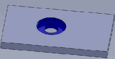

Deletes a set of faces from a temporary body.
