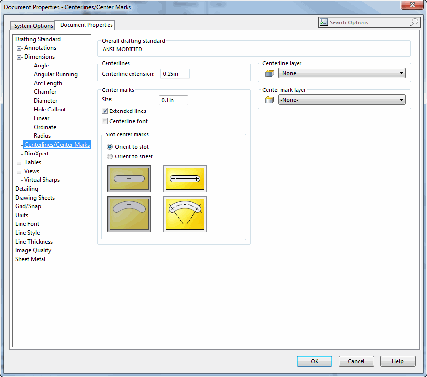

Setting |
Get/Set Methods |
Return Value or <Value> |
Comments |
Centerlines - Centerline extension |
IModelDocExtension::GetUserPreferenceDouble(swUserPreferenceDoubleValue_e.swDetailingCenterlineExtension,
swUserPreferenceOption_e.swDetailingNoOptionSpecified)
IModelDocExtension::SetUserPreferenceDouble(swUserPreferenceDoubleValue_e.swDetailingCenterlineExtension,
swUserPreferenceOption_e.swDetailingNoOptionSpecified, <Value>) |
Double value in meters |
Specifies length to extend the centerline beyond section geometry when
in a drawing view |
Center marks - Size |
IModelDocExtension::GetUserPreferenceDouble(swUserPreferenceDoubleValue_e.swDetailingCenterMarkSize,
IModelDocExtension::SetUserPreferenceDouble(swUserPreferenceDoubleValue_e.swDetailingCenterMarkSize,
Specifies the size of center marks in drawings |
Center marks - Extended lines |
IModelDocExtension::GetUserPreferenceToggle(swUserPreferenceToggle_e.swDetailingCenterMarkShowLines,
IModelDocExtension::SetUserPreferenceToggle(swUserPreferenceToggle_e.swDetailingCenterMarkShowLines,
Boolean value |
Specifies whether to display center mark extension lines |
Center marks - Centerline font |
IModelDocExtension::GetUserPreferenceToggle(swUserPreferenceToggle_e.swDetailingCenterMarkUseCenterLine,
IModelDocExtension::SetUserPreferenceToggle(swUserPreferenceToggle_e.swDetailingCenterMarkUseCenterLine,
Boolean value |
Specifies whether lines in center marks use font specified for centerlines |
Slot center marks - Orient to slot or Orient to sheet |
IModelDocExtension::GetUserPreferenceInteger(swUserPreferenceIntegerValue_e.swCenterLineMarkOrient,
IModelDocExtension::SetUserPreferenceInteger(swUserPreferenceIntegerValue_e.swCenterLineMarkOrient,
swUserPreferenceOption_e.swDetailingNoOptionSpecified, swCenterLineMarkOrient_e.<Value>) |
See swCenterLineMarkOrient_e
for valid options |
Specifies the orientation of the centerline marks |
Slot center marks - Place mark at centers of straight slots |
IModelDocExtension::GetUserPreferenceToggle(swUserPreferenceToggle_e.swCenterLineMarkLinear,
IModelDocExtension::SetUserPreferenceToggle(swUserPreferenceToggle_e.swCenterLineMarkLinear,
Boolean value |
Specifies placement of marks at centers of straight slots |
Slot center marks - Place mark at ends of straight slots |
IModelDocExtension::GetUserPreferenceToggle(swUserPreferenceToggle_e.swCenterLineMarkEndsOnlyLinear,
IModelDocExtension::SetUserPreferenceToggle(swUserPreferenceToggle_e.swCenterLineMarkEndsOnlyLinear,
Boolean value |
Specifies placement of marks at ends of straight slots; only available
with Slot center marks - Orient to slot
option |
Slot center marks - Place mark at centers of arc slots |
IModelDocExtension::GetUserPreferenceToggle(swUserPreferenceToggle_e.swCenterLineMarkCircular,
IModelDocExtension::SetUserPreferenceToggle(swUserPreferenceToggle_e.swCenterLineMarkCircular,
Boolean value |
Specifies placement of marks at centers of arc slots |
Slot center marks - Place mark at ends of arc slots |
IModelDocExtension::GetUserPreferenceToggle(swUserPreferenceToggle_e.swCenterLineMarkEndsOnlyCircular,
IModelDocExtension::SetUserPreferenceToggle(swUserPreferenceToggle_e.swCenterLineMarkEndsOnlyCircular,
Boolean value |
Specifies placement of marks at ends of arc slots; only available with
option |
Centerline layer |
IModelDocExtension::GetUserPreferenceString(swUserPreferenceStringValue_e.swCenterLineLayer,
IModelDocExtension::SetUserPreferenceString(swUserPreferenceStringValue_e.swCenterLineLayer,
Valid Options:
- "Border"
- "Dimensions"
- "Notes"
- "BOM"
- "FORMAT"
Depending on the drawing, some
options may not apply |
Center mark layer |
IModelDocExtension::GetUserPreferenceString(swUserPreferenceStringValue_e.swCenterMarkLayer,
IModelDocExtension::SetUserPreferenceString(swUserPreferenceStringValue_e.swCenterMarkLayer,
Valid Options:
- "Border"
- "Dimensions"
- "Notes"
- "BOM"
- "FORMAT"
Depending on drawing, some
