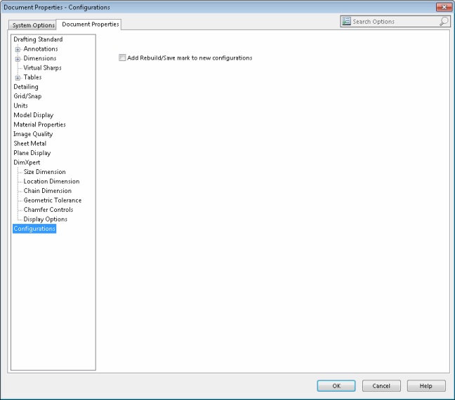

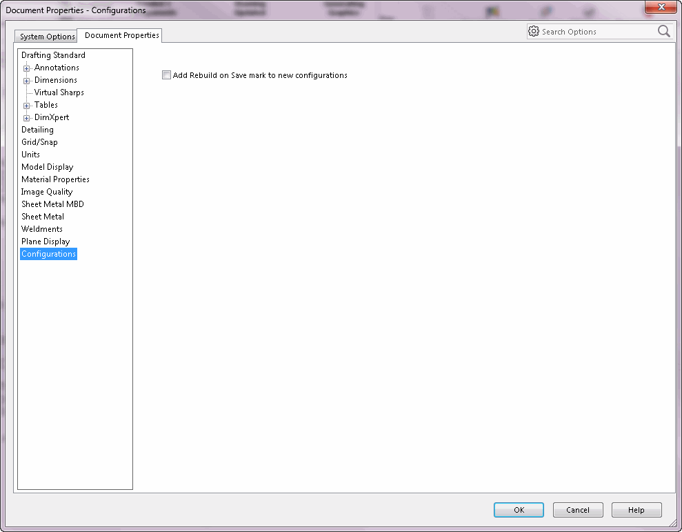

Document Properties > Configurations
Setting
Get/Set Methods
Return Value or <Value>
Comments
Add Rebuild/Save mark to new configurations
IModelDocExtension::GetUserPreferenceToggle(swUserPreferenceToggle_e.swRebuildSaveNewConfig, swUserPreferenceOption_e.swDetailingNoOptionSpecified)
IModelDocExtension::SetUserPreferenceToggle(swUserPreferenceToggle_e.swReguildSaveNewConfig, swUserPreferenceOption_e.swDetailingNoOptionSpecified, <Value>)
Boolean value
Specifies whether to apply the Rebuild/Save mark to new configurations.
