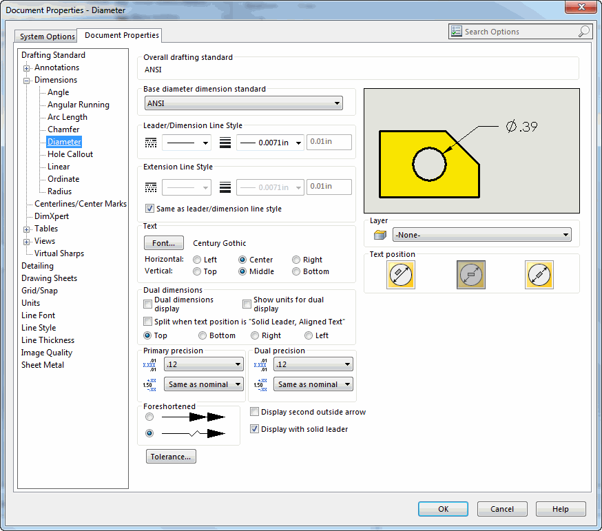

Setting |
Get/Set Methods |
Return Value or <Value> |
Comments |
Base diameter dimension standard |
IModelDocExtension::GetUserPreferenceInteger(swUserPreferenceIntegerValue_e.swDetailingDimensionStandard,
swUserPreferenceOption_e.swDetailingDiameterDimension)
IModelDocExtension::SetUserPreferenceInteger(swUserPreferenceIntegerValue_e.swDetailingDimensionStandard,
swUserPreferenceOption_e.swDetailingDiameterDimension, swDetailingStandard_e.<Value>) |
See swDetailingStandard_e
for valid options |
Specifies the base diameter dimensioning standard to use |
Leader/Dimension Line Style - Leader Style |
IModelDocExtension::GetUserPreferenceInteger(swUserPreferenceIntegerValue_e.swLineFontDimensionsStyle,
IModelDocExtension::SetUserPreferenceInteger(swUserPreferenceIntegerValue_e.swLineFontDimensionsStyle,
swUserPreferenceOption_e.swDetailingDiameterDimension, swLineStyles_e.<Value>) |
See swLineStyles_e
for valid options |
Specifies style of leader lines for diameter dimensions |
Leader/Dimension Line Style - Leader Thickness |
IModelDocExtension::GetUserPreferenceInteger(swUserPreferenceIntegerValue_e.swLineFontDimensionsThickness,
IModelDocExtension::SetUserPreferenceInteger(swUserPreferenceIntegerValue_e.swLineFontDimensionsThickness,
swUserPreferenceOption_e.swDetailingDiameterDimension, swLineWeights_e.<Value>) |
See swLineWeights_e
for valid options |
Specifies thickness of leader lines for diameter dimensions |
Leader/Dimension Line Style - Custom Thickness |
IModelDocExtension::GetUserPreferenceDouble(swUserPreferenceDoubleValue_e.swLineFontDimensionsThicknessCustom,
IModelDocExtension::SetUserPreferenceDouble(swUserPreferenceDoubleValue_e.swLineFontDimensionsThicknessCustom,
swUserPreferenceOption_e.swDetailingDiameterDimension, <Value>) |
Double value |
Specifies a custom thickness for leader lines in diameter dimensions; sets Custom Thickness
to the specified thickness and
Leader Thickness to Custom Size |
Extension Line Style - Extension Line Style |
IModelDocExtension::GetUserPreferenceInteger(swUserPreferenceIntegerValue_e.swDimensionsExtensionLineStyle,
IModelDocExtension::SetUserPreferenceInteger(swUserPreferenceIntegerValue_e.swDimensionsExtensionLineStyle,
See swLineStyles_e
for valid options |
Specifies style of extension lines for diameter dimensions |
Extension Line Style - Extension Line Thickness |
IModelDocExtension::GetUserPreferenceInteger(swUserPreferenceIntegerValue_e.swDimensionsExtensionLineStyleThickness,
IModelDocExtension::SetUserPreferenceInteger(swUserPreferenceIntegerValue_e.swDimensionsExtensionLineStyleThickness,
See swLineWeights_e
for valid options |
Specifies thickness of extension lines for diameter dimensions |
Extension Line Style - Custom Thickness |
IModelDocExtension::GetUserPreferenceDouble(swUserPreferenceDoubleValue_e.swDimensionsExtensionLineStyleThicknessCustom,
IModelDocExtension::SetUserPreferenceDouble(swUserPreferenceDoubleValue_e.swDimensionsExtensionLineStyleThicknessCustom,
Double value |
Specifies a custom thickness for extension lines in diameter dimensions; sets Custom Thickness
Extension Line Thickness to Custom Size |
Extension Line Style - Same as leader/dimension line style |
IModelDocExtension::GetUserPreferenceToggle(swUserPreferenceToggle_e.swDimensionsExtensionLineStyleSameAsLeader,
IModelDocExtension::SetUserPreferenceToggle(swUserPreferenceToggle_e.swDimensionsExtensionLineStyleSameAsLeader,
Boolean value |
Specifies whether the extension line style is the same as the
Text - Font... |
IModelDocExtension::GetUserPreferenceTextFormat(swUserPreferenceTextFormat_e.swDetailingDimensionTextFormat,
IModelDocExtension::SetUserPreferenceTextFormat(swUserPreferenceTextFormat_e.swDetailingDimensionTextFormat,
See ITextFormat
for font options |
To set font property values, implement ITextFormat, set the appropriate
ITextFormat member values, and pass the ITextFormat object in the API
set method |
Text - Horizontal |
IModelDocExtension::GetUserPreferenceInteger(swUserPreferenceIntegerValue_e.swDetailingDimensionTextAlignmentHorizontal,
IModelDocExtension::SetUserPreferenceInteger(swUserPreferenceIntegerValue_e.swDetailingDimensionTextAlignmentHorizontal,
swUserPreferenceOption_e.swDetailingDiameterDimension, swTextJustification_e.<Value>) |
See swTextJustification_e
for valid options |
Text - Vertical |
IModelDocExtension::GetUserPreferenceInteger(swUserPreferenceIntegerValue_e.swDetailingDimensionTextAlignmentVertical,
IModelDocExtension::SetUserPreferenceInteger(swUserPreferenceIntegerValue_e.swDetailingDimensionTextAlignmentVertical,
swUserPreferenceOption_e.swDetailingDiameterDimension, swTextAlignmentVertical_e.<Value>) |
See swTextAlignmentVertical_e
for valid options |
Dual dimensions - Dual dimensions display |
IModelDocExtension::GetUserPreferenceToggle(swUserPreferenceToggle_e.swDetailingDualDimensions,
IModelDocExtension::SetUserPreferenceToggle(swUserPreferenceToggle_e.swDetailingDualDimensions,
Boolean value |
Specifies whether to display dimensions in two kinds of units |
Dual dimensions - Show units for dual display |
IModelDocExtension::GetUserPreferenceToggle(swUserPreferenceToggle_e.swDetailingShowDualDimensionUnits,
IModelDocExtension::SetUserPreferenceToggle(swUserPreferenceToggle_e.swDetailingShowDualDimensionUnits,
Boolean value |
Specifies whether to display units for dual dimensions; available only on
drawings |
Dual dimensions - Split when text position is "Solid Leader, Aligned
Text" |
IModelDocExtension::GetUserPreferenceToggle(swUserPreferenceToggle_e.swDetailingSplitDualDimension,
IModelDocExtension::SetUserPreferenceToggle(swUserPreferenceToggle_e.swDetailingSplitDualDimension,
Boolean value |
Specifies whether to display dual dimensions above and below dimension lines; valid only if Text position is swDisplayDimensionLeaderText_e.swSolidLeaderAlignedText |
Dual dimensions - Dimension position |
IModelDocExtension::GetUserPreferenceInteger(swUserPreferenceIntegerValue_e.swDetailingDualDimPosition,
IModelDocExtension::SetUserPreferenceInteger(swUserPreferenceIntegerValue_e.swDetailingDualDimPosition,
swUserPreferenceOption_e.swDetailingDiameterDimension, swDetailingDualDimPosition_e.<Value>) |
See swDetailingDualDimPosition_e
for valid options |
Positions the display of dimensions in two kinds of units |
Primary precision - Unit Precision |
IModelDocExtension::GetUserPreferenceInteger(swUserPreferenceIntegerValue_e.swDetailingLinearDimPrecision,
IModelDocExtension::SetUserPreferenceInteger(swUserPreferenceIntegerValue_e.swDetailingLinearDimPrecision,
Number of decimal places to display; 0 through 8 |
Specifies primary precision for linear dimension |
Primary precision - Tolerance Precision |
IModelDocExtension::GetUserPreferenceInteger(swUserPreferenceIntegerValue_e.swDetailingLinearTolPrecision,
IModelDocExtension::SetUserPreferenceInteger(swUserPreferenceIntegerValue_e.swDetailingLinearTolPrecision,
swUserPreferenceOption_e.swDetailingDiameterDimension, swDimensionPrecisionSettings_e
.<Value>) |
See swDimensionPrecisionSettings_e
for valid options |
Specifies primary precision for tolerance |
Dual precision - Unit Precision |
IModelDocExtension::GetUserPreferenceInteger(swUserPreferenceIntegerValue_e.swDetailingAltLinearDimPrecision,
IModelDocExtension::SetUserPreferenceInteger(swUserPreferenceIntegerValue_e.swDetailingAltLinearDimPrecision,
Specifies dual precision for alternate linear dimension |
Dual precision - Tolerance Precision |
IModelDocExtension::GetUserPreferenceInteger(swUserPreferenceIntegerValue_e.swDetailingAltLinearTolPrecision,
IModelDocExtension::SetUserPreferenceInteger(swUserPreferenceIntegerValue_e.swDetailingAltLinearTolPrecision,
.<Value>) |
for valid options |
Specifies dual precision for alternate linear tolerance |
Foreshortened |
IModelDocExtension::GetUserPreferenceInteger(swUserPreferenceIntegerValue_e.swDetailingForeshortenedDiameterStyle,
swUserPreferenceOption_e.swDetailingNoOptionSpecified)
IModelDocExtension::SetUserPreferenceInteger(swUserPreferenceIntegerValue_e.swDetailingForeshortenedDiameterStyle,
swUserPreferenceOption_e.swDetailingNoOptionSpecified, swDetailingForeshortenedDiameterStyle_e
.<Value>) |
See swDetailingForeshortenedDiameterStyle_e
for valid options |
Display second outside arrow |
IModelDocExtension::GetUserPreferenceToggle(swUserPreferenceToggle_e.swDetailingRadialDimsDisplay2ndOutsideArrow,
IModelDocExtension::SetUserPreferenceToggle(swUserPreferenceToggle_e.swDetailingRadialDimsDisplay2ndOutsideArrow,
Boolean value |
Specifies whether to display two outside arrows |
Display with solid leader |
IModelDocExtension::GetUserPreferenceToggle(swUserPreferenceToggle_e.swDetailingRadialDimsDisplayWithSolidLeader, swUserPreferenceOption_e.swDetailingDiameterDimension)
IModelDocExtension::SetUserPreferenceToggle(swUserPreferenceToggle_e.swDetailingRadialDimsDisplayWithSolidLeader, swUserPreferenceOption_e.swDetailingDiameterDimension, <Value>) |
Boolean value |
Specifies whether to display diameter dimensions with solid leaders |
Tolerance... |
See Comments |
See Comments |
See Dimension Tolerance |
Layer |
IModelDocExtension::GetUserPreferenceString(swUserPreferenceStringValue_e.swDetailingLayer,
IModelDocExtension::SetUserPreferenceString(swUserPreferenceStringValue_e.swDetailingLayer,

Text position |
IModelDocExtension::GetUserPreferenceInteger(swUserPreferenceIntegerValue_e.swDetailingDimensionTextAndLeaderStyle,
IModelDocExtension::SetUserPreferenceInteger(swUserPreferenceIntegerValue_e.swDetailingDimensionTextAndLeaderStyle,
swUserPreferenceOption_e.swDetailingDiameterDimension, swDisplayDimensionLeaderText_e.<Value>) |
See swDisplayDimensionLeaderText_e
for valid options |
Specifies how to display leader |
