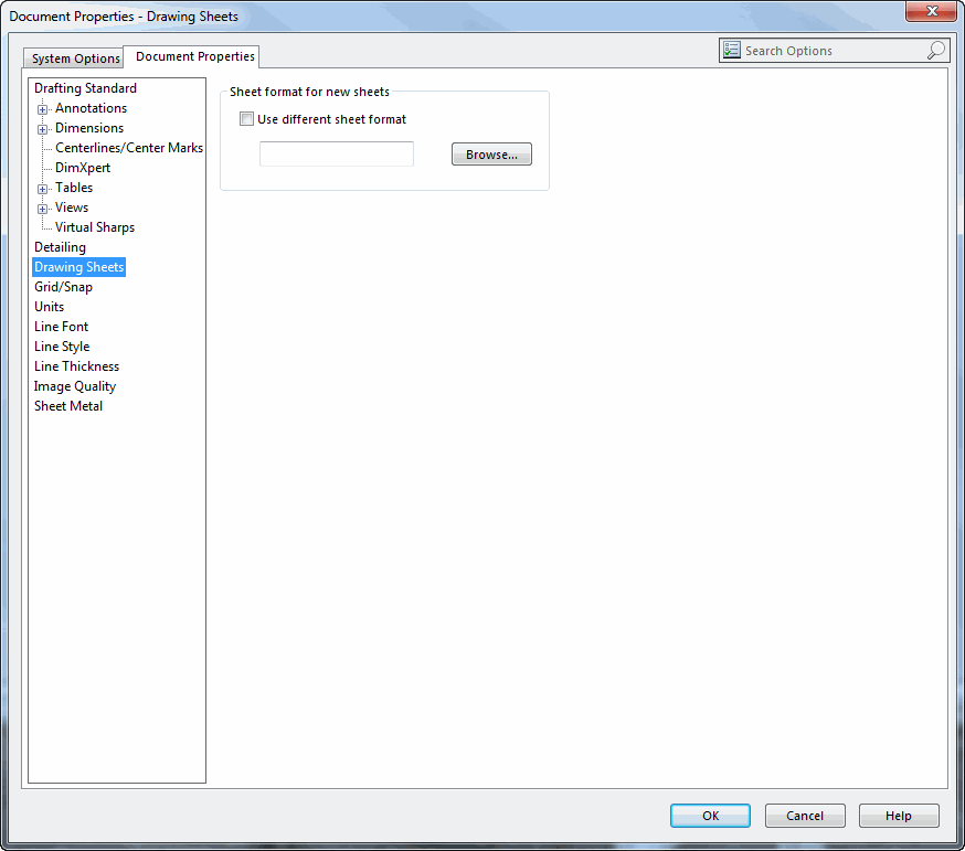

Sheet format for new sheets - Use different sheet format |
IModelDocExtension::GetUserPreferenceToggle(swUserPreferenceToggle_e.swDrawingSheetUseDifferentSheetFormat,
swUserPreferenceOption_e.swDetailingNoOptionSpecified)
IModelDocExtension::SetUserPreferenceToggle(swUserPreferenceToggle_e.swDrawingSheetUseDifferentSheetFormat,
swUserPreferenceOption_e.swDetailingNoOptionSpecified, <Value>) |
Boolean value |
Specifies whether to use a different sheet format
Sheet format for new sheets - Sheet format file location |
IModelDocExtension::GetUserPreferenceString(swUserPreferenceStringValue_e.swFileLocationsNewSheetFormat,
IModelDocExtension::SetUserPreferenceString(swUserPreferenceStringValue_e.swFileLocationsNewSheetFormat,
String value |
Specifies the location of the sheet format file to use |
