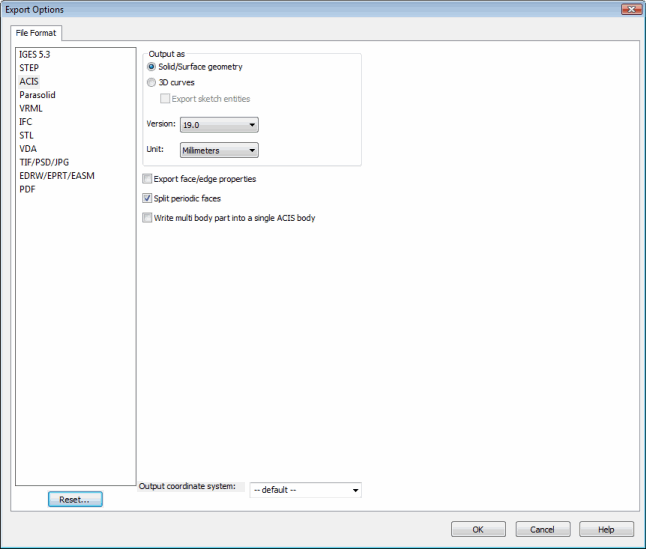

Setting |
Get/Set Methods |
Return Value
or
<Value>
or
<OnFlag> |
Comment |
Output as - Solid/Surface geometry |
ISldWorks::GetUserPreferenceIntegerValue(swUserPreferenceIntegerValue_e.swAcisOutputGeometryPreference)
ISldWorks::SetUserPreferenceIntegerValue(swUserPreferenceIntegerValue_e.swAcisOutputGeometryPreference,
swAcisOutputGeometryPreference_e.swAcisOutputAsSolidAndSurface) |
swAcisOutputGeometryPreference_e.swAcisOutputAsSolidAndSurface |
Output as - 3D curves |
swAcisOutputGeometryPreference_e.swAcisOutputAs3DCurves) |
swAcisOutputGeometryPreference_e.swAcisOutputAs3DCurves |
Output as - Export sketch entities |
swAcisOutputGeometryPreference_e.swAcisOutputAs3DCurves_IncludeSketchEnts)
swAcisOutputGeometryPreference_e.swAcisOutputAs3DCurves_IncludeSketchEnts |
Output as - Version |
ISldWorks::GetUserPreferenceIntegerValue(swUserPreferenceIntegerValue_e.swOutputVersion)
ISldWorks::SetUserPreferenceIntegerValue(swUserPreferenceIntegerValue_e.swOutputVersion,
swACISOutputVersion_e.<Value>)
See swACISOutputVersion_e
for valid options |
Output as - Unit |
ISldWorks::GetUserPreferenceIntegerValue(swUserPreferenceIntegerValue_e.swAcisOutputUnits)
ISldWorks::SetUserPreferenceIntegerValue(swUserPreferenceIntegerValue_e.swAcisOutputUnits,
swLengthUnit_e.<Value>)
See swLengthUnit_e
for valid options
Export face/edge properties |
ISldWorks::GetUserPreferenceToggle(swUserPreferenceToggle_e.swSATExportFaceEdgeProps)
ISldWorks::SetUserPreferenceToggle(swUserPreferenceToggle_e.swSATExportFaceEdgeProps,
<OnFlag>) |
Boolean value |
Specifies whether to export face and edge properties |
Split periodic faces |
ISldWorks::GetUserPreferenceToggle(swUserPreferenceToggle_e.swSATExportSplitPeriodic)
ISldWorks::SetUserPreferenceToggle(swUserPreferenceToggle_e.swSATExportSplitPeriodic,
<OnFlag>) |
Boolean value |
Specifies whether to split periodic faces on export |
Write multi body part into a single
ACIS body |
ISldWorks::GetUserPreferenceToggle(swUserPreferenceToggle_e.swSATExportMultLumpsToSingleBody)
ISldWorks::SetUserPreferenceToggle(swUserPreferenceToggle_e.swSATExportMultLumpsToSingleBody,
<OnFlag>) |
Boolean value |
Output coordinate system |
IModelDocExtension::GetUserPreferenceString(swUserPreferenceString_e.swFileSaveAsCoordinateSystem,
swUserPreferenceOption_e.swDetailingNoOptionSpecified)
IModelDocExtension::SetUserPreferenceString(swUserPreferenceString_e.swFileSaveAsCoordinateSystem,
swUserPreferenceOption_e.swDetailingNoOptionSpecified, <Value>) |
String value |
Contains the name of the transform coordinate system; an empty string
signifies that the default
coordinate system that does not require a transform; coordinate settings
are not saved with the document; they must be selected at export time |
