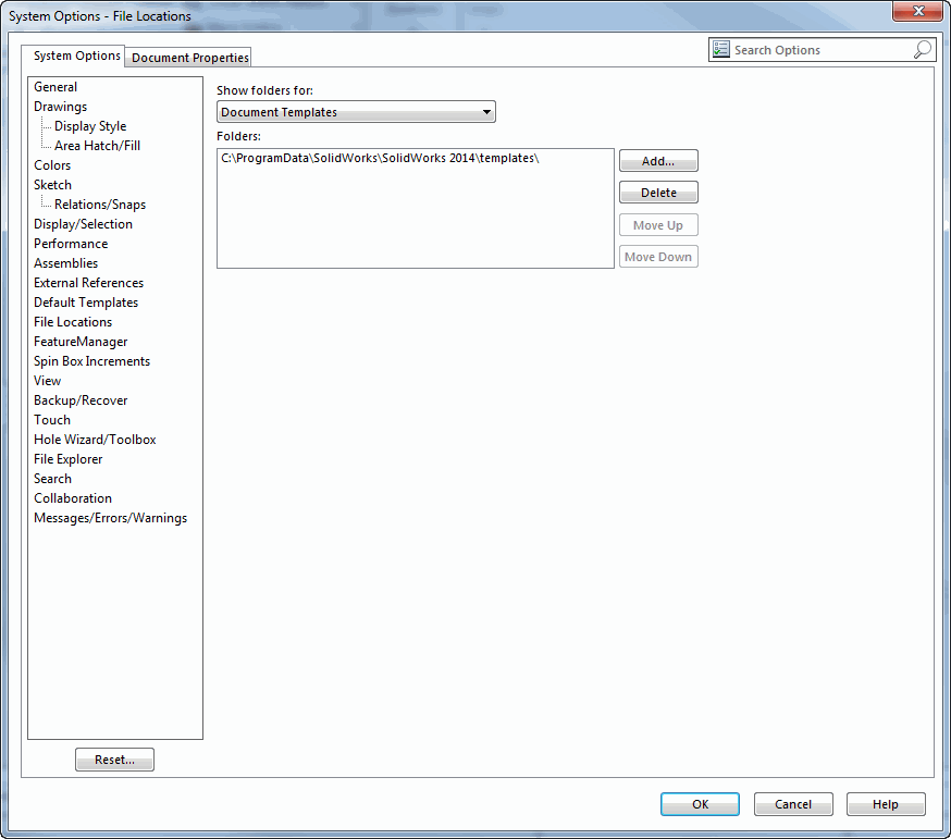

This topic contains two tables. The information in the table:
Setting |
Get/Set Methods |
Return Value
or
<Value> |
Comment |
Show folders for - Document Templates - Folders |
ISldWorks::GetUserPreferenceStringValue(swUserPreferenceStringValue_e.swFileLocationsDocumentTemplates)
ISldWorks::SetUserPreferenceStringValue(swUserPreferenceStringValue_e.swFileLocationsDocumentTemplates,
<Value>) |

Template Folder |
ISldWorks::GetUserPreferenceStringValue(swUserPreferenceStringValue_e.swFileLocationsCostingReportTemplateFolder)
ISldWorks::SetUserPreferenceStringValue(swUserPreferenceStringValue_e.swFileLocationsCostingReportTemplateFolder,
<Value>) |
String value |
Show folders for - Costing templates |
ISldWorks::GetUserPreferenceStringValue(swUserPreferenceStringValue_e.swFileLocationsCostingTemplates)
ISldWorks::SetUserPreferenceStringValue(swUserPreferenceStringValue_e.swFileLocationsCostingTemplates,
<Value>) |
String value |
Show folders for - Weld Table
Template |
ISldWorks::GetUserPreferenceStringValue(swUserPreferenceStringValue_e.swFileLocationsWeldTableTemplate)
ISldWorks::SetUserPreferenceStringValue(swUserPreferenceStringValue_e.swFileLocationsWeldTableTemplate,
<Value>) |
String value |
Show folders for - Bend Table
Template |
ISldWorks::GetUserPreferenceStringValue(swUserPreferenceStringValue_e.swFileLocationsBendTableTemplate)
ISldWorks::SetUserPreferenceStringValue(swUserPreferenceStringValue_e.swFileLocationsBendTableTemplate,
<Value>) |
String value |
Show folders for - Punch Table
Template |
ISldWorks::GetUserPreferenceStringValue(swUserPreferenceStringValue_e.swFileLocationsPunchTableTemplate)
ISldWorks::SetUserPreferenceStringValue(swUserPreferenceStringValue_e.swFileLocationsPunchTableTemplate,
<Value>) |
String value |
