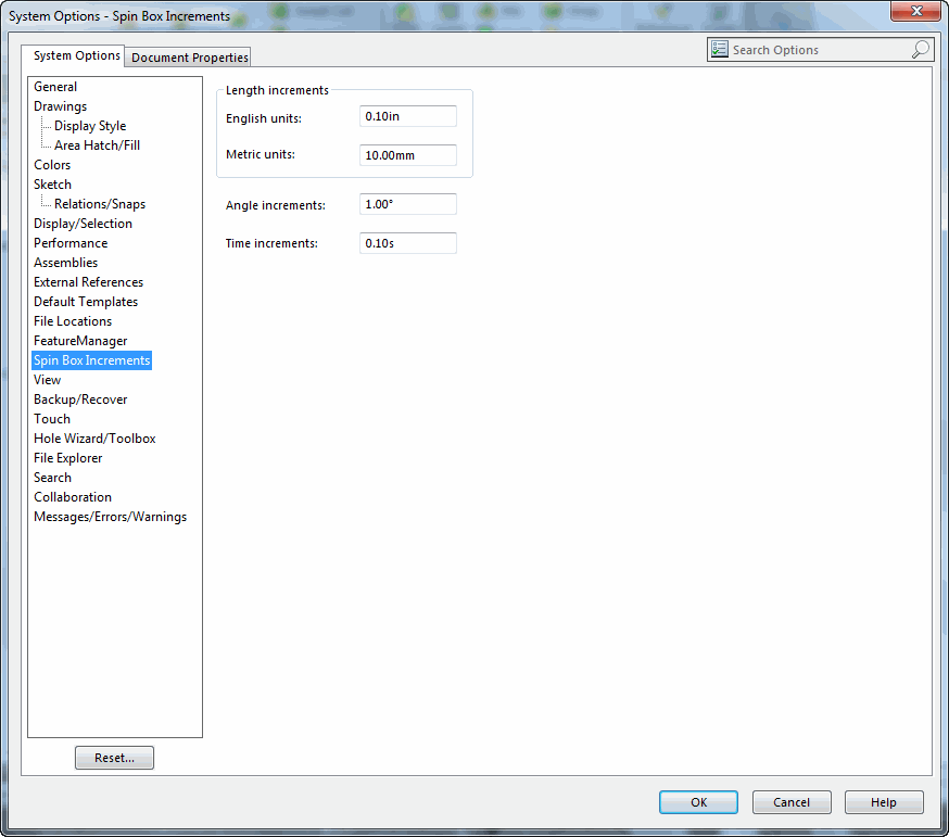

Setting |
Get/Set Methods |
Return Value
or
<Value> |
Comment |
Length increments - English units |
ISldWorks::GetUserPreferenceDoubleValue(swUserPreferenceDoubleValue_e.swSpinBoxEnglishLengthIncrement)
ISldWorks::SetUserPreferenceDoubleValue(swUserPreferenceDoubleValue_e.swSpinBoxEnglishLengthIncrement,
<Value>) |
Double value in inches |
Specifies number of inches added or subtracted when spin box arrow is
clicked to change a linear dimension value; see Units
to learn how to set length units using the SolidWorks API |
Length increments - Metric units |
ISldWorks::GetUserPreferenceDoubleValue(swUserPreferenceDoubleValue_e.swSpinBoxMetricLengthIncrement)
ISldWorks::SetUserPreferenceDoubleValue(swUserPreferenceDoubleValue_e.swSpinBoxMetricLengthIncrement,
<Value>) |
Double value in metric units |
Specifies number of units added or subtracted when a spin box arrow
is clicked to change a linear dimension value; see Units
Angle increments |
ISldWorks::GetUserPreferenceDoubleValue(swUserPreferenceDoubleValue_e.swSpinBoxAngleIncrement)
ISldWorks::SetUserPreferenceDoubleValue(swUserPreferenceDoubleValue_e.swSpinBoxAngleIncrement,
<Value>) |
Double value in angular units |
Specifies number of angular units added or subtracted when a spin box
arrow is clicked to change an angular dimension value; see Units
to learn how to set angular units using the SolidWorks API |
Time increments |
ISldWorks::GetUserPreferenceDoubleValue(swUserPreferenceDoubleValue_e.swSpinBoxTimeIncrement)
ISldWorks::SetUserPreferenceDoubleValue(swUserPreferenceDoubleValue_e.swSpinBoxTimeIncrement,
<Value>) |
Double value in time units |
is clicked to change a time value; see Units
to learn how to set time units using the SolidWorks API |
