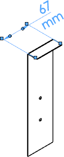

For ISO Drafting Standard dimensions with solid leader and aligned text, you can use the Dimension PropertyManager to place text above and below dimension lines, or split dual-dimension text above and below dimension lines.
You use the Dimension Text field in the PropertyManager to place text. You can split text only if the Text Position is set to Solid Leader, Aligned Text tools_options_dims_radius_solid_aligned.gif in Tools > Options > Document Properties > Dimensions .
