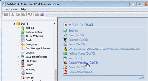

The Recently Used list appears in the right pane of the SOLIDWORKS Enterprise PDM Administration tool. It provides quick access to the last ten administration features you have used.
EPDM_Admin_tool_recently_used
The Recently Used list is retained when you close the Administration tool. When you reopen the tool, you can see the history of the work you did in your previous session.
Click Clear to remove all of the items that are currently in the list.
