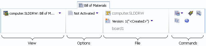

Use the Bill of Materials tab to view a SOLIDWORKS assembly or drawing BOM table.
To display a SOLIDWORKS BOM:
Select a SOLIDWORKS assembly or drawing that contains a BOM. On the Bill of Materials tab, for BOM, select a BOM with the icon.
BOM_UI_SolidWork_BOM
View
BOM_UI_BOM_control Bill of Materials BOM types available for this assembly or drawing.
Options
BOM_UI_Not_Activated_control Activation Controls whether the BOM is visible in the Bill of Materials view.
File
Source file (Read-only) The assembly or drawing file name.
File Version Lets you select the source file version for which to display the BOM.
Configuration (Read-only) The configuration for the BOM.
Commands
BOM_UI_Save_BOM Save Select Save to save the SOLIDWORKS Bill of Materials, or Save As to save the bill of materials to a named BOM.
BOM_UI_Open_as_CSV_file Open As CSV File Opens the BOM in Excel as a comma-delimited file.
Search Searches the BOM for a text string.
Compare BOM Changes the Bill of Materials tab layout so that you can select a second BOM to compare.
Help Accesses context-sensitive help.
