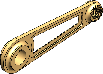

  1. Open install_dir\samples\whatsnew\parts\arm.sldprt.
    arm
  2. In the FeatureManager design tree, right-click Cut-Extrude2 and select Delete delete.gif.
