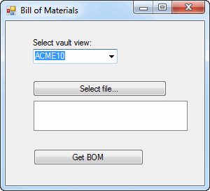

Access Bill of Materials Example (C#)
This example shows how to access the Bill of
Materials (BOM) of a file in the vault.
NOTE: If using the .NET Framework 4.0 primary interop assembly
provided with SolidWorks Enterprise PDM, see
Using .NET Framework 4.0 in
Stand-alone Applications.
![](AccessBOM.gif)

// 8. Click Debug > Start Debugging or press F5.
// Postconditions:
// 1. The Bill of Materials dialog box displays.
// a. Select a vault_name view.
// b. Click Select file.
// c. In the Select File dialog:
// 1. Click the assembly specified in
Preconditions step 5.
// 2. Click Open.
// d. Click Get BOM.
// Displays message boxes containing:
// * Information about all named BOMs of the
assembly.
// * Version information for the named BOMs.
// * Information about all BOM layouts in
the vault.
// * Row and column information about a BOM
view in the BOM layout
// for the selected assembly in
its @ configuration.
// e. Click OK in the message boxes.
// 2. Close the Bill of Materials dialog box.

this.GetBOM.Click += new System.EventHandler(this.GetBOM_Click);
//OpenFileDialog1
this.OpenFileDialog1.FileName = "OpenFileDialog1";
this.OpenFileDialog1.Title = "Select File";
//Form1
this.AutoScaleDimensions = new System.Drawing.SizeF(6f, 13f);
this.AutoScaleMode = System.Windows.Forms.AutoScaleMode.Font;
this.ClientSize = new System.Drawing.Size(284, 235);
this.Controls.Add(this.GetBOM);
this.Controls.Add(this.File1List);
this.Controls.Add(this.SelectFiles);
this.Controls.Add(this.VaultsComboBox);
this.Controls.Add(this.VaultsLabel);
this.Name = "Form1";
this.Text = "Bill of Materials";
this.Load += new System.EventHandler(this.Form1_Load);
this.ResumeLayout(false);
this.PerformLayout();
internal System.Windows.Forms.Label VaultsLabel;
internal System.Windows.Forms.ComboBox VaultsComboBox;
internal System.Windows.Forms.Button SelectFiles;
internal System.Windows.Forms.ListBox File1List;
internal System.Windows.Forms.Button GetBOM;
internal System.Windows.Forms.OpenFileDialog OpenFileDialog1;
