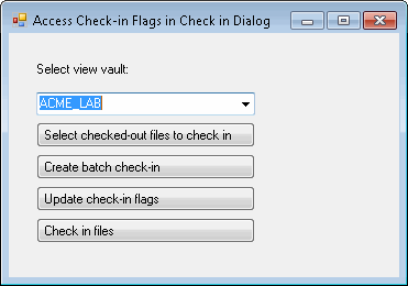

'  4. Click Debug > Start Debugging or press F5.
' Postconditions:
'  1. Displays the Access Check-in Flags in Check in Dialog dialog box.
'  2. Select a vault view.
'  3. Click Select checked-out files to check in.
'     a. Displays the Select files dialog box.
'     b. Click one or more checked-out files to check in.
'     c. Click Open.
'  4. Click Create batch check-in.
'     a. At the end of an attempted check-in, displays three message
'        boxes containing ProgressEnd called. Three operations occur for an
'        attempted check-in.
'     b. Click OK to close each message box.
'     c. Displays either:
'        * Message box containing Batch check-in created. Click OK to
'          close the message box.
'          - or -
'        * Message box containing You did not select a file to check in. Please try
'          again. Click OK to close the message box, and repeat steps 3 and 4.
'  5. Click Update check-in flags.
'  6. Click OK to close the message box.
'  7. Click Check in files.
'  8. Displays the Check in dialog box.
'  9. Click Check in to check in the files or Cancel to cancel the check in.
' 10. Displays a message box containing ProgressEnd called. Click OK to close
'     the message box.
' 11. Examine the files in the vault to verify their checked-in or checked-out status.
' 12. Close the Access Check-in Flags in Check in Dialog dialog box.

        Me.VaultsComboBox.Size = New System.Drawing.Size(199, 21)
        Me.VaultsComboBox.TabIndex = 1
        'BrowseButton
        Me.BrowseButton.Location = New System.Drawing.Point(25, 81)
        Me.BrowseButton.Name = "BrowseButton"
        Me.BrowseButton.Size = New System.Drawing.Size(199, 23)
        Me.BrowseButton.TabIndex = 2
        Me.BrowseButton.Text = "Select checked-out files to check in"
        Me.BrowseButton.TextAlign = System.Drawing.ContentAlignment.MiddleLeft
        Me.BrowseButton.UseVisualStyleBackColor = True
        'CreateBatchCheckinButton
        Me.CreateBatchCheckinButton.Location = New System.Drawing.Point(25, 110)
        Me.CreateBatchCheckinButton.Name = "CreateBatchCheckinButton"
        Me.CreateBatchCheckinButton.Size = New System.Drawing.Size(199, 23)
        Me.CreateBatchCheckinButton.TabIndex = 3
        Me.CreateBatchCheckinButton.Text = "Create batch check-in"
        Me.CreateBatchCheckinButton.TextAlign = System.Drawing.ContentAlignment.MiddleLeft
        Me.CreateBatchCheckinButton.UseVisualStyleBackColor = True
        'UpdateBatchCheckInButton
        Me.UpdateBatchCheckInButton.Location = New System.Drawing.Point(25, 139)
        Me.UpdateBatchCheckInButton.Name = "UpdateBatchCheckInButton"
        Me.UpdateBatchCheckInButton.Size = New System.Drawing.Size(199, 23)
        Me.UpdateBatchCheckInButton.TabIndex = 4
        Me.UpdateBatchCheckInButton.Text = "Update check-in flags"
        Me.UpdateBatchCheckInButton.TextAlign = System.Drawing.ContentAlignment.MiddleLeft
        Me.UpdateBatchCheckInButton.UseVisualStyleBackColor = True
        'CheckInButton
        Me.CheckInButton.Location = New System.Drawing.Point(25, 168)
        Me.CheckInButton.Name = "CheckInButton"
        Me.CheckInButton.Size = New System.Drawing.Size(199, 23)
        Me.CheckInButton.TabIndex = 5
        Me.CheckInButton.Text = "Check in files"
        Me.CheckInButton.TextAlign = System.Drawing.ContentAlignment.MiddleLeft
        Me.CheckInButton.UseVisualStyleBackColor = True
        'Form1
        Me.AutoScaleDimensions = New System.Drawing.SizeF(6.0!, 13.0!)
        Me.AutoScaleMode = System.Windows.Forms.AutoScaleMode.Font
        Me.ClientSize = New System.Drawing.Size(355, 222)
        Me.Controls.Add(Me.CheckInButton)
        Me.Controls.Add(Me.UpdateBatchCheckInButton)
        Me.Controls.Add(Me.CreateBatchCheckinButton)
        Me.Controls.Add(Me.BrowseButton)
        Me.Controls.Add(Me.VaultsComboBox)
        Me.Controls.Add(Me.VaultsLabel)
        Me.Name = "Form1"
        Me.Text = "Access Check-in Flags in Check in Dialog"
        Me.ResumeLayout(False)
        Me.PerformLayout()
    End Sub
    Friend WithEvents VaultsLabel As System.Windows.Forms.Label
    Friend WithEvents VaultsComboBox As System.Windows.Forms.ComboBox
    Friend WithEvents BrowseButton As System.Windows.Forms.Button
    Friend WithEvents CreateBatchCheckinButton As System.Windows.Forms.Button
    Friend WithEvents UpdateBatchCheckInButton As System.Windows.Forms.Button
    Friend WithEvents CheckInButton As System.Windows.Forms.Button
End Class
