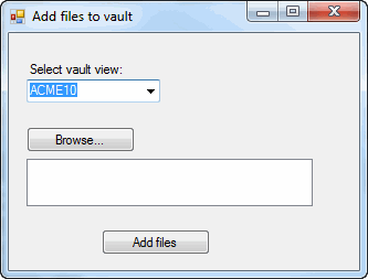

Add Files to Vault Example (C#)
This example shows how to add files to a vault.
NOTE: If using the .NET Framework 4.0 primary interop assembly
provided with SolidWorks Enterprise PDM, see
Using .NET Framework 4.0 in
Stand-alone Applications.
![](AddFiles.gif)
// Preconditions:
// 1. Start Microsoft Visual Studio 2010.
// a. Click File > New > Project > Visual
C# > Windows Forms Application.
// b. Type AddFiles_CSharp in Name.
// c. Click Browse and navigate to the folder where to create
// the project.
// d. Click OK.
// e. Click Show All Files in the Solution Explorer toolbar and expand
// Form1.cs in the Solution Explorer.
// f. Replace the code in Form1.cs with this code.
// g. To create the form,
replace the code in Form1.Designer.cs with this code.
// 2. Add EPDM.Interop.epdm.dll as a reference (right-click the project
// name in the Solution Explorer, click Add Reference, click
// Assemblies > Framework in the left-side panel, browse to the top folder of
// your SolidWorks Enterprise PDM installation, locate and click
// EPDM.Interop.epdm.dll, click Open, and click Add).
// 3. Add Microsoft.VisualBasic as a reference (click COM in the left-side panel,
// click Microsoft.VisualBasic, click Add, and click Close).
// 4. Right-click EPDM.Interop.epdm in References, click Properties, and set
// Embed Interop Types to False to handle methods that pass arrays of
// structures.
// 5. Ensure that a vault workflow with state, Waiting for Approval, exists.
// 6. Click Debug > Start Debugging or press F5.
// Postconditions:
// 1. Displays the Add
files to vault dialog box.
// a. Select a vault view.
// b. Click Browse.
1. Locate and click three files outside the vault.
// 2. Click Open.
// c. Click
Add files.
// 1.
Adds the selected files to the root
folder of the vault.
2. Checks in the files.
3. Creates path, \temp\files, in the root folder.
4. Moves one of the files to subfolder, \temp\files.
5. Copies one of the files to subfolder, \temp.
6. Changes the state of one of the files in the root folder to
Waiting for Approval.
// 2. Observe the changes in the vault.
// 3. Close the Add

this.AddFiles.Size = new System.Drawing.Size(98, 23);
this.AddFiles.TabIndex = 5;
this.AddFiles.Text = "Add files";
this.AddFiles.UseVisualStyleBackColor = true;
this.AddFiles.Click +=new System.EventHandler(AddFiles_Click);
//OpenFileDialog
this.OpenFileDialog.Multiselect = true;
this.OpenFileDialog.Title = "Open";
//Form1
this.AutoScaleDimensions = new System.Drawing.SizeF(6f, 13f);
this.AutoScaleMode = System.Windows.Forms.AutoScaleMode.Font;
this.ClientSize = new System.Drawing.Size(317, 215);
this.Controls.Add(this.AddFiles);
this.Controls.Add(this.ListBox);
this.Controls.Add(this.BrowseButton);
this.Controls.Add(this.VaultsComboBox);
this.Controls.Add(this.VaultsLabel);
this.Name = "Form1";
this.Text = "Add files to vault";
this.Load += new System.EventHandler(this.Form1_Load);
this.ResumeLayout(false);
this.PerformLayout();
#endregion
internal System.Windows.Forms.Label VaultsLabel;
internal System.Windows.Forms.ComboBox VaultsComboBox;
internal System.Windows.Forms.Button BrowseButton;
internal System.Windows.Forms.ListBox ListBox;
internal System.Windows.Forms.Button AddFiles;
internal System.Windows.Forms.OpenFileDialog OpenFileDialog;
