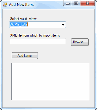

Add Items Example (VB.NET)
This example shows how to add items to a vault. The data for the items is imported from an XML file, which is read by the .NET XmlReader.
NOTE: If using the .NET Framework 4.0 primary interop assembly provided with SolidWorks Enterprise PDM, see Using .NET Framework 4.0 in Stand-alone Applications.
' Preconditions:
'  1. Create an XML file for this example.
'     a. Open a text editor like Notepad and copy and paste this code
'        into the editor.
'     b. Save the file as Items.xml and remember where you save the file.
'  2. Open the SolidWorks Enterprise PDM Administration tool.
'  3. Log into the vault where to add a new serial number.
'     a. Right-click Serial Numbers and click New Serial Number.
'        1. Type AddItems in Name.
'        2. For Format string, click the right-arrow button and select Counter value > 00001.
'        3. Click OK.
'     b. Right-click Items and select Open.
'        1. Click AddItems in Item Serial Number.
'        2. Click OK.
'  4. Start Microsoft Visual Studio 2010.
'     a. Click File > New > Project > Visual Basic > Windows Forms Application.
'     b. Type AddItems in Name.
'     c. Click the Browse button and browse to the folder where to create the project.
'     d. Click OK.
'     e. Click Show All Files in the Solution Explorer toolbar.
'     f. Create a form similar to the form shown above and change:
'        1. Top label to VaultsLabel.
'        2. Combo box to VaultsComboBox.
'        3. Second label to XmlLabel.
'        4. Text box to XmlTextBox.
'        5. Browse button to BrowseButton.
'        6. Add items button to AddItemsButton.
'        7. List box to ItemsListBox.
'     g. Replace the code in Form1.vb with this code.
'     h. Replace the code in Form1.Designer.vb with this code.
'     i. Right-click the AddItems project name in the Solution Explorer.
'        1. Click Add > Class > Class.
'        2. Type EdmVaultSingleton.vb in Name.
'        3. Click Add.
'        4. Replace the code in EdmVaultSingleton.vb with this code.
'     j. Right-click the AddItems project name in the Solution Explorer.
'        2. Type NewItem.vb in Name.
'        3. Click Add.
'        4. Replace the code in NewItem.vb with this code.
'  5. Add EPDM.Interop.epdm.dll as a reference (right-click the project
'     name in the Solution Explorer, click Add Reference, click
'     Assemblies > Framework in the left-side panel, browse to the top folder of your
'     SolidWorks Enterprise PDM installation, locate and click
'     EPDM.Interop.epdm.dll, click Open, click Add, and click Close).
'  6. Right-click EPDM.Interop.epdm in References, click Properties, and set
'     Embed Interop Types to False to handle methods that pass arrays of
'     structures.
'  7. Click Debug > Start Debugging or press F5.
' Postconditions:
'  1. Displays a dialog.
'  2. Select a vault.
'  3. Click the Browse button, locate and click Items.xml, and click Open.
'  4. Click the Add items button.
'     The new items are printed in the dialog's list.
'  5. Close the dialog.
'  6. Open the SolidWorks Enterprise PDM Item Explorer tool.
'     (In Windows 7, click Start > All Programs > SolidWorks Enterprise PDM >
'     Item Explorer.)
'  7. Expand the vault where the new items were added.
'     The new items are listed below the name of the expanded vault.

   <System.Diagnostics.DebuggerStepThrough()> _
   Private Sub InitializeComponent()
        Me.BrowseButton = New System.Windows.Forms.Button()
        Me.XmlTextBox = New System.Windows.Forms.TextBox()
        Me.XmlLabel = New System.Windows.Forms.Label()
        Me.XmlOpenFileDialog = New System.Windows.Forms.OpenFileDialog()
        Me.AddItemsButton = New System.Windows.Forms.Button()
        Me.VaultsComboBox = New System.Windows.Forms.ComboBox()
        Me.VaultsLabel = New System.Windows.Forms.Label()
        Me.ItemsListBox = New System.Windows.Forms.ListBox()
        Me.SuspendLayout()
        'BrowseButton
        Me.BrowseButton.Location = New System.Drawing.Point(222, 94)
        Me.BrowseButton.Margin = New System.Windows.Forms.Padding(2)
        Me.BrowseButton.Name = "BrowseButton"
        Me.BrowseButton.Size = New System.Drawing.Size(59, 26)
        Me.BrowseButton.TabIndex = 0
        Me.BrowseButton.Text = "Browse..."
        Me.BrowseButton.UseVisualStyleBackColor = True
        'XmlTextBox
        Me.XmlTextBox.Location = New System.Drawing.Point(24, 94)
        Me.XmlTextBox.Margin = New System.Windows.Forms.Padding(2)
        Me.XmlTextBox.Name = "XmlTextBox"
        Me.XmlTextBox.Size = New System.Drawing.Size(182, 20)
        Me.XmlTextBox.TabIndex = 1
        'XmlLabel
        Me.XmlLabel.AutoSize = True
        Me.XmlLabel.Location = New System.Drawing.Point(22, 78)
        Me.XmlLabel.Margin = New System.Windows.Forms.Padding(2, 0, 2, 0)
        Me.XmlLabel.Name = "XmlLabel"
        Me.XmlLabel.Size = New System.Drawing.Size(172, 13)
        Me.XmlLabel.TabIndex = 2
        Me.XmlLabel.Text = "XML file from which to import items:"
        'XmlOpenFileDialog
        Me.XmlOpenFileDialog.Filter = "XML files|*.xml"
        'AddItemsButton
        Me.AddItemsButton.Location = New System.Drawing.Point(29, 139)
        Me.AddItemsButton.Margin = New System.Windows.Forms.Padding(2)
        Me.AddItemsButton.Name = "AddItemsButton"
        Me.AddItemsButton.Size = New System.Drawing.Size(87, 24)
        Me.AddItemsButton.TabIndex = 3
        Me.AddItemsButton.Text = "Add items"
        Me.AddItemsButton.UseVisualStyleBackColor = True
        'VaultsComboBox
        Me.VaultsComboBox.FormattingEnabled = True
        Me.VaultsComboBox.Location = New System.Drawing.Point(22, 40)
        Me.VaultsComboBox.Margin = New System.Windows.Forms.Padding(2)
        Me.VaultsComboBox.Name = "VaultsComboBox"
        Me.VaultsComboBox.Size = New System.Drawing.Size(184, 21)
        Me.VaultsComboBox.TabIndex = 12
        'VaultsLabel
        Me.VaultsLabel.AutoSize = True
        Me.VaultsLabel.Location = New System.Drawing.Point(22, 24)
        Me.VaultsLabel.Margin = New System.Windows.Forms.Padding(2, 0, 2, 0)
        Me.VaultsLabel.Name = "VaultsLabel"
        Me.VaultsLabel.Size = New System.Drawing.Size(94, 13)
        Me.VaultsLabel.TabIndex = 13
        Me.VaultsLabel.Text = "Select vault  view:"
        'ItemsListBox
        Me.ItemsListBox.FormattingEnabled = True
        Me.ItemsListBox.Location = New System.Drawing.Point(29, 175)
        Me.ItemsListBox.Margin = New System.Windows.Forms.Padding(2)
        Me.ItemsListBox.Name = "ItemsListBox"
        Me.ItemsListBox.Size = New System.Drawing.Size(253, 121)
        Me.ItemsListBox.TabIndex = 14
        'AddItems
        Me.AutoScaleDimensions = New System.Drawing.SizeF(6.0!, 13.0!)
        Me.AutoScaleMode = System.Windows.Forms.AutoScaleMode.Font
        Me.ClientSize = New System.Drawing.Size(299, 320)
        Me.Controls.Add(Me.ItemsListBox)
        Me.Controls.Add(Me.VaultsComboBox)
        Me.Controls.Add(Me.VaultsLabel)
        Me.Controls.Add(Me.AddItemsButton)
        Me.Controls.Add(Me.XmlLabel)
        Me.Controls.Add(Me.XmlTextBox)
        Me.Controls.Add(Me.BrowseButton)
        Me.Margin = New System.Windows.Forms.Padding(2)
        Me.Name = "AddItems"
        Me.Text = "Add New Items"
        Me.ResumeLayout(False)
        Me.PerformLayout()
    End Sub
   Friend WithEvents BrowseButton As System.Windows.Forms.Button
   Friend WithEvents XmlTextBox As System.Windows.Forms.TextBox
   Friend WithEvents XmlLabel As System.Windows.Forms.Label
   Friend WithEvents XmlOpenFileDialog As System.Windows.Forms.OpenFileDialog
   Friend WithEvents AddItemsButton As System.Windows.Forms.Button
   Friend WithEvents VaultsComboBox As System.Windows.Forms.ComboBox
   Friend WithEvents VaultsLabel As System.Windows.Forms.Label
   Friend WithEvents ItemsListBox As System.Windows.Forms.ListBox
End Class
