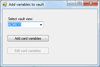

Add Card Variables to Vault Example (C#)
This example shows how to add card variables to a vault and
edit them.

// Postconditions:
// 1. Displays the Add
variables to vault dialog box.
// 2. Select a vault view.
// 3. Click Add
card variables.
a. Adds two card variables, MyNewVar and MySecondVar, to the vault.
// b. Displays a message box with the IDs of the new
variables.
// c. Click OK.
// 4. Click Edit card variables.
// a. Displays the Edit Variables dialog box.
// b. Click OK.
// c. Displays a message box.
// d. Click OK.
// 5. Close the Add
