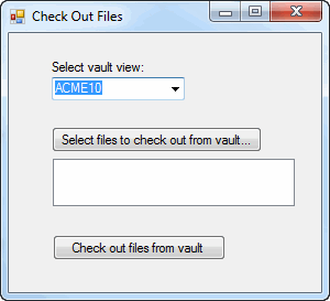

Batch Check Out Files Example (C#)
This example shows how to check out several files from the vault in one batch.

// Postconditions:
//  1. The Check Out Files dialog box displays.
//     a. Select a vault view.
//     b. Click Select files to check out from vault.
//     c. In the Select File dialog:
//        1. Click a couple of files inside the vault.
//        2. Click Open.
//     d. Click Check out files from vault.
//  2. Click Check Out in the Check Out dialog box.
//  3. Close the Check Out Files dialog box.
//  4. Observe that the selected files are checked out of the selected vault.
