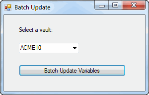

This example shows how to update file and folder card
variables in one batch.

// Postconditions:
// 1. Displays the Batch Update dialog box.
// a. Select a vault.
// b. Click Batch Update Variables.
// * Updates the Title and Comment
variables in the data cards
// only of checked-out
text files.
// * Updates the Description variable
of the data cards of all folders
// with the word
Folder in
their names.
// * Displays a message box saying
Card variables updated.
// c. Click OK to close the message box.
// 2. Close the Batch Update dialog box.
