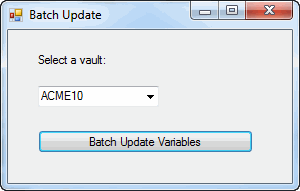

This example shows how to update file and folder card
variables in one batch.

' Postconditions:
' 1. Displays the Batch Update dialog box.
' a. Select a vault.
' b. Click Batch Update Variables.
' * Updates the Title and Comment
variables in the data cards
' only of checked-out
text files.
' * Updates the Description variable
of the data cards of all folders
' with the word Folder in
their names.
' * Displays a message box saying
Card variables updated.
' c. Click OK to close the message box.
' 2. Close the Batch Update dialog box.
3. Inspect the data cards of any checked-out text files and folders with
' the word Folder in their names in the selected vault.
