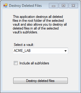

This example shows how to create an application that displays a form in which
a user can select the vault in whose root
folder and subfolders all deleted files will be permanently destroyed. The user must have permission to delete
files.

' 6. Create a form similar to the form shown above
and change:
a. Second label to VaultsLabel.
' b. Combo box to
VaultsComboBox.
' c. Check box to CheckBox_Recursive.
d.
Button to DestroyDeletedItemsButton.

' Postconditions:
' 1. Displays the Destroy Deleted Files dialog.
' 2. Select a vault.
' 3. Optionally select the Include all subfolders check box.
' 4. Click the Destroy deleted files button.
' A message box pops up informing you that:
' * No deleted files were found to destroy.
' - or -
' * The deleted files were destroyed.
' 5. Click OK in the message box.
' 6. Close the Destroy Deleted Files dialog.
