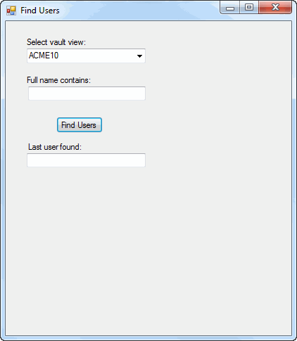

// Postconditions:
//  1. Displays the Find Users dialog box.
//     a. Select a vault view.
//     b. In Full name contains, type a substring of the full name of a
//        user that exists in the vault.
//     c. Click Find Users.
//        A message box confirms the substring typed in Postconditions
//        step 1b.
//     d. Click OK.
//        Displays a Search for users dialog.
//     e. Click Find.
//        Displays a Search for users dialog with results.
//     f. Click the first row.
//     g. Click Select.
//        * Displays a message box with the updated user information.
//        * The selected user's phone and website information are updated.
//     h. Click OK.
//  2. Updates the Find Users dialog box with the full name and picture,
//     if it exists, of the last user found whose full name contains the substring
//     typed in Postconditions step 1b.
//  3. Close the Find Users dialog box.

            // FindUsers
            this.FindUsers.Location = new System.Drawing.Point(72, 136);
            this.FindUsers.Name = "FindUsers";
            this.FindUsers.Size = new System.Drawing.Size(66, 23);
            this.FindUsers.TabIndex = 0;
            this.FindUsers.Text = "Find Users";
            this.FindUsers.TextAlign = System.Drawing.ContentAlignment.MiddleLeft;
            this.FindUsers.UseVisualStyleBackColor = true;
            this.FindUsers.Click += new System.EventHandler(this.FindUsers_Click);
            // VaultsComboBox
            this.VaultsComboBox.FormattingEnabled = true;
            this.VaultsComboBox.Location = new System.Drawing.Point(30, 39);
            this.VaultsComboBox.Name = "VaultsComboBox";
            this.VaultsComboBox.Size = new System.Drawing.Size(169, 21);
            this.VaultsComboBox.TabIndex = 1;
            // Label1
            this.Label1.AutoSize = true;
            this.Label1.Location = new System.Drawing.Point(27, 23);
            this.Label1.Name = "Label1";
            this.Label1.Size = new System.Drawing.Size(91, 13);
            this.Label1.TabIndex = 2;
            this.Label1.Text = "Select vault view:";
            // Label2
            this.Label2.AutoSize = true;
            this.Label2.Location = new System.Drawing.Point(27, 77);
            this.Label2.Name = "Label2";
            this.Label2.Size = new System.Drawing.Size(98, 13);
            this.Label2.TabIndex = 3;
            this.Label2.Text = "Full name contains:";
            // TextBox1
            this.TextBox1.Location = new System.Drawing.Point(32, 93);
            this.TextBox1.Name = "TextBox1";
            this.TextBox1.Size = new System.Drawing.Size(167, 20);
            this.TextBox1.TabIndex = 4;
            // Label3
            this.Label3.AutoSize = true;
            this.Label3.Location = new System.Drawing.Point(29, 172);
            this.Label3.Name = "Label3";
            this.Label3.Size = new System.Drawing.Size(83, 13);
            this.Label3.TabIndex = 6;
            this.Label3.Text = "Last user found:";
            // TextBox2
            this.TextBox2.Location = new System.Drawing.Point(30, 188);
            this.TextBox2.Name = "TextBox2";
            this.TextBox2.Size = new System.Drawing.Size(169, 20);
            this.TextBox2.TabIndex = 7;
            // Form1
            this.AutoScaleDimensions = new System.Drawing.SizeF(6F, 13F);
            this.AutoScaleMode = System.Windows.Forms.AutoScaleMode.Font;
            this.ClientSize = new System.Drawing.Size(406, 447);
            this.Controls.Add(this.TextBox2);
            this.Controls.Add(this.Label3);
            this.Controls.Add(this.TextBox1);
            this.Controls.Add(this.Label2);
            this.Controls.Add(this.Label1);
            this.Controls.Add(this.VaultsComboBox);
            this.Controls.Add(this.FindUsers);
            this.Name = "Form1";
            this.Text = "Find Users";
            this.Load += new System.EventHandler(this.Form1_Load);
            this.ResumeLayout(false);
            this.PerformLayout();
