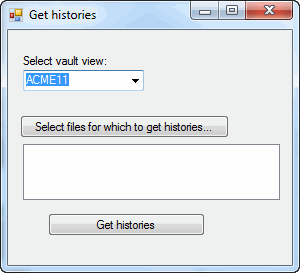

Get Histories of Files Example (VB.NET)
This example shows how to update version comments and get histories
of files.

![](GetHistories.gif)

' Postconditions:
' 1. Displays the Get histories dialog box.
' a. Select a vault view.
' b. Click Select files for
which to get histories.
' c. In the Select File dialog:
' 1. Select one
or more checked-in vault files.
' 2. Click Open.
3. Updates all version comments for the selected files to
' "New comment".
' d. Click Get
histories.
' e. Displays a message box for each history item.
' f. Observe the updated version comments.
' g. Click OK to close each message box.
' 2. Close the Get histories dialog box.
