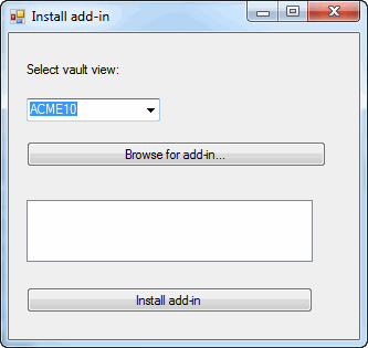

Install Add-in Example (VB.NET)
This example shows how to install an add-in and obtain information about it.
NOTE: If using the .NET Framework 4.0 primary interop assembly provided with SolidWorks Enterprise PDM, see Using .NET Framework 4.0 in Stand-alone Applications.
' Preconditions:
'  1. Start Microsoft Visual Studio 2010.
'     a. Click File > New > Project > Visual Basic > Windows Forms Application.
'     b. Type AddinMgr in Name.
'     c. Click Browse and navigate to the folder where to create the project.
'     d. Click OK
'     e. Click Show All Files in the Solution Explorer toolbar and expand
'        Form1.vb in the Solution Explorer.
'     f. Create a form similar to the form shown above and change:
'        1. Top label to VaultsLabel.
'        2. Combo box to VaultsComboBox.
'        3. Browse for add-in button to BrowseButton.
'        4. List box to AddinListBox.
'        5. Install add-in button to LoadAddin.
'     g. Replace the code in Form1.vb with this code.
'     h. Replace the code in Form1.Designer.vb with this code.
'  2. Add EPDM.Interop.epdm.dll as a reference (right-click the project
'     name in the Solution Explorer, click Add Reference, click
'     Assemblies > Framework in the left-side panel, browse to the top folder of
'     your SolidWorks Enterprise PDM installation, locate and click
'     EPDM.Interop.epdm.dll, click Open, click Add, and click Close).
'  3. Right-click EPDM.Interop.epdm in References, click Properties, and set
'     Embed Interop Types to False to handle methods that pass arrays of
'     structures.
'  4. Click Debug > Start Debugging or press F5.
' Postconditions:
'  1. The Install add-in dialog box displays.
'     a. Select a vault view.
'     b. Click Browse for add-in.
'     c. In the Browse for add-ins dialog:
'        1. Navigate to your add-in directory and click addin_name.dll
'           and Interop.EdmLib.dll.
'        2. Click Open.
'     d. Click Install add-in.
'        A message box containing information about each add-in installed in
'        the selected vault displays.
'     e. Click OK to close each message box.
'  2. Close the Install add-in dialog box.

        Me.AddinOpenFileDialog = New System.Windows.Forms.OpenFileDialog()
        Me.SuspendLayout()
        'VaultsLabel
        Me.VaultsLabel.AutoSize = True
        Me.VaultsLabel.Location = New System.Drawing.Point(13, 26)
        Me.VaultsLabel.Name = "VaultsLabel"
        Me.VaultsLabel.Size = New System.Drawing.Size(91, 13)
        Me.VaultsLabel.TabIndex = 0
        Me.VaultsLabel.Text = "Select vault view:"
        'VaultsComboBox
        Me.VaultsComboBox.FormattingEnabled = True
        Me.VaultsComboBox.Location = New System.Drawing.Point(16, 59)
        Me.VaultsComboBox.Name = "VaultsComboBox"
        Me.VaultsComboBox.Size = New System.Drawing.Size(121, 21)
        Me.VaultsComboBox.TabIndex = 1
        'BrowseButton
        Me.BrowseButton.Location = New System.Drawing.Point(16, 98)
        Me.BrowseButton.Name = "BrowseButton"
        Me.BrowseButton.Size = New System.Drawing.Size(271, 23)
        Me.BrowseButton.TabIndex = 3
        Me.BrowseButton.Text = "Browse for add-in..."
        Me.BrowseButton.UseVisualStyleBackColor = True
        'AddinListBox
        Me.AddinListBox.FormattingEnabled = True
        Me.AddinListBox.HorizontalScrollbar = True
        Me.AddinListBox.Location = New System.Drawing.Point(16, 151)
        Me.AddinListBox.Name = "AddinListBox"
        Me.AddinListBox.SelectionMode = System.Windows.Forms.SelectionMode.MultiSimple
        Me.AddinListBox.Size = New System.Drawing.Size(259, 56)
        Me.AddinListBox.TabIndex = 4
        'LoadAddin
        Me.LoadAddin.Location = New System.Drawing.Point(16, 230)
        Me.LoadAddin.Name = "LoadAddin"
        Me.LoadAddin.Size = New System.Drawing.Size(259, 23)
        Me.LoadAddin.TabIndex = 5
        Me.LoadAddin.Text = "Install add-in"
        Me.LoadAddin.UseVisualStyleBackColor = True
        'AddinOpenFileDialog
        Me.AddinOpenFileDialog.Multiselect = True
        Me.AddinOpenFileDialog.Title = "Browse for add-ins"
        'Form1
        Me.AutoScaleDimensions = New System.Drawing.SizeF(6.0!, 13.0!)
        Me.AutoScaleMode = System.Windows.Forms.AutoScaleMode.Font
        Me.ClientSize = New System.Drawing.Size(317, 277)
        Me.Controls.Add(Me.LoadAddin)
        Me.Controls.Add(Me.AddinListBox)
        Me.Controls.Add(Me.BrowseButton)
        Me.Controls.Add(Me.VaultsComboBox)
        Me.Controls.Add(Me.VaultsLabel)
        Me.Name = "Form1"
        Me.Text = "Install add-in"
        Me.ResumeLayout(False)
        Me.PerformLayout()
    End Sub
#End Region
    Friend WithEvents VaultsLabel As System.Windows.Forms.Label
    Friend WithEvents VaultsComboBox As System.Windows.Forms.ComboBox
    Friend WithEvents BrowseButton As System.Windows.Forms.Button
    Friend WithEvents AddinListBox As System.Windows.Forms.ListBox
    Friend WithEvents LoadAddin As System.Windows.Forms.Button
    Friend WithEvents AddinOpenFileDialog As System.Windows.Forms.OpenFileDialog
