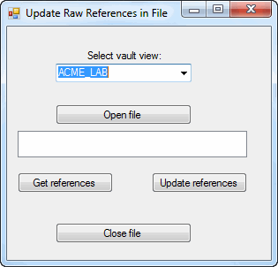

' Postconditions:
'  1. Displays the Update Raw References in File dialog box.
'  2. Select the vault view where the SolidWorks assembly or
'     drawing document that you checked out in
'     Preconditions step 4 resides.
'  3. Click Open file.
'  4. Displays the Open a file dialog box.
'     a. Click the assembly or drawing document you checked
'        out in Preconditions step 4.
'     b. Click Open.
'     The opened file's path and file name appear
'     in the Update Raw References in File dialog box.
'  5. Click Get references.
'     a. Displays a message box for each referenced file.
'        The referenced file's ID, path and file name, file name,
'        type, and number of times referenced appear in the
'        message box.
'     b. Click OK to close each message box.
'  6. Rename one of the referenced files in the selected vault
'     in Windows Explorer.
'  7. Click Update references.
'     a. Displays a message box confirming that references were updated.
'     b. Click OK to close the message box.
'  8. Click Get references.
'        message box. Note that the renamed file is now a referenced
'        file of the open document.
'  9. Click Close file.
' 10. Click OK to close the message box confirming that the
'     open document was closed.
' 11. Close the Update Raw References in File dialog box.

        Me.OpenButton.UseVisualStyleBackColor = True
        'GetButton
        Me.GetButton.Location = New System.Drawing.Point(12, 165)
        Me.GetButton.Name = "GetButton"
        Me.GetButton.Size = New System.Drawing.Size(108, 23)
        Me.GetButton.TabIndex = 3
        Me.GetButton.Text = "Get references"
        Me.GetButton.UseVisualStyleBackColor = True
        'UpdateButton
        Me.UpdateButton.Location = New System.Drawing.Point(164, 165)
        Me.UpdateButton.Name = "UpdateButton"
        Me.UpdateButton.Size = New System.Drawing.Size(108, 23)
        Me.UpdateButton.TabIndex = 4
        Me.UpdateButton.Text = "Update references"
        Me.UpdateButton.UseVisualStyleBackColor = True
        'CloseButton
        Me.CloseButton.Location = New System.Drawing.Point(55, 222)
        Me.CloseButton.Name = "CloseButton"
        Me.CloseButton.Size = New System.Drawing.Size(154, 23)
        Me.CloseButton.TabIndex = 5
        Me.CloseButton.Text = "Close file"
        Me.CloseButton.UseVisualStyleBackColor = True
        'FileListBox
        Me.FileListBox.FormattingEnabled = True
        Me.FileListBox.Location = New System.Drawing.Point(12, 118)
        Me.FileListBox.Name = "FileListBox"
        Me.FileListBox.Size = New System.Drawing.Size(260, 30)
        Me.FileListBox.TabIndex = 6
        'OpenFileDialog1
        Me.OpenFileDialog1.FileName = "OpenFileDialog1"
        Me.OpenFileDialog1.Multiselect = True
        Me.OpenFileDialog1.Title = "Open a file"
        'Form1
        Me.AutoScaleDimensions = New System.Drawing.SizeF(6.0!, 13.0!)
        Me.AutoScaleMode = System.Windows.Forms.AutoScaleMode.Font
        Me.ClientSize = New System.Drawing.Size(284, 264)
        Me.Controls.Add(Me.FileListBox)
        Me.Controls.Add(Me.CloseButton)
        Me.Controls.Add(Me.UpdateButton)
        Me.Controls.Add(Me.GetButton)
        Me.Controls.Add(Me.OpenButton)
        Me.Controls.Add(Me.VaultsComboBox)
        Me.Controls.Add(Me.Label1)
        Me.Name = "Form1"
        Me.Text = "Update References in File"
        Me.ResumeLayout(False)
        Me.PerformLayout()
    End Sub
    Friend WithEvents Label1 As System.Windows.Forms.Label
    Friend WithEvents VaultsComboBox As System.Windows.Forms.ComboBox
    Friend WithEvents OpenButton As System.Windows.Forms.Button
    Friend WithEvents GetButton As System.Windows.Forms.Button
    Friend WithEvents UpdateButton As System.Windows.Forms.Button
    Friend WithEvents CloseButton As System.Windows.Forms.Button
    Friend WithEvents FileListBox As System.Windows.Forms.ListBox
    Friend WithEvents OpenFileDialog1 As System.Windows.Forms.OpenFileDialog
End Class
