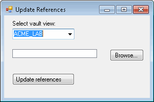

// Postconditions:
//  1. Displays your Update References dialog box.
//  2. Select a vault view.
//  3. Click Browse.
//  4. Displays the Select a file dialog box.
//     a. Click a file in the selected vault.
//     b. Click Open.
//     The selected file's path and file name appear
//     in the Select a file dialog box.
//  5. Click Update references.
//  6. Initializes and displays SolidWorks Enterprise PDM's Update References
//     dialog box, which shows the name of the selected file whose file references
//     to update and the names of the file references, if any.
//  7. Click Close.
//  8. Close your Update References dialog box.

        private void InitializeComponent()
            this.Label1 = new System.Windows.Forms.Label();
            this.VaultsComboBox = new System.Windows.Forms.ComboBox();
            this.FileListBox = new System.Windows.Forms.ListBox();
            this.BrowseButton = new System.Windows.Forms.Button();
            this.UpdateReferencesButton = new System.Windows.Forms.Button();
            this.OpenFileDialog1 = new System.Windows.Forms.OpenFileDialog();
            this.SuspendLayout();
            // Label1
            this.Label1.AutoSize = true;
            this.Label1.Location = new System.Drawing.Point(13, 9);
            this.Label1.Name = "Label1";
            this.Label1.Size = new System.Drawing.Size(91, 13);
            this.Label1.TabIndex = 0;
            this.Label1.Text = "Select vault view:";
            // VaultsComboBox
            this.VaultsComboBox.FormattingEnabled = true;
            this.VaultsComboBox.Location = new System.Drawing.Point(16, 26);
            this.VaultsComboBox.Name = "VaultsComboBox";
            this.VaultsComboBox.Size = new System.Drawing.Size(121, 21);
            this.VaultsComboBox.TabIndex = 1;
            // FileListBox
            this.FileListBox.FormattingEnabled = true;
            this.FileListBox.Location = new System.Drawing.Point(16, 66);
            this.FileListBox.Name = "FileListBox";
            this.FileListBox.Size = new System.Drawing.Size(165, 17);
            this.FileListBox.TabIndex = 2;
            // BrowseButton
            this.BrowseButton.Location = new System.Drawing.Point(206, 66);
            this.BrowseButton.Name = "BrowseButton";
            this.BrowseButton.Size = new System.Drawing.Size(66, 23);
            this.BrowseButton.TabIndex = 3;
            this.BrowseButton.Text = "Browse...";
            this.BrowseButton.UseVisualStyleBackColor = true;
            this.BrowseButton.Click += new System.EventHandler(this.BrowseButton_Click);
            // UpdateReferencesButton
            this.UpdateReferencesButton.Location = new System.Drawing.Point(16, 113);
            this.UpdateReferencesButton.Name = "UpdateReferencesButton";
            this.UpdateReferencesButton.Size = new System.Drawing.Size(121, 23);
            this.UpdateReferencesButton.TabIndex = 4;
            this.UpdateReferencesButton.Text = "Update references";
            this.UpdateReferencesButton.TextAlign = System.Drawing.ContentAlignment.MiddleLeft;
            this.UpdateReferencesButton.UseVisualStyleBackColor = true;
            this.UpdateReferencesButton.Click += new System.EventHandler(this.UpdateReferencesButton_Click);
            // OpenFileDialog1
            this.OpenFileDialog1.FileName = "OpenFileDialog1";
            this.OpenFileDialog1.Multiselect = true;
            this.OpenFileDialog1.Title = "Select a file";
            // Form1
            this.AutoScaleDimensions = new System.Drawing.SizeF(6F, 13F);
            this.AutoScaleMode = System.Windows.Forms.AutoScaleMode.Font;
            this.ClientSize = new System.Drawing.Size(284, 161);
            this.Controls.Add(this.UpdateReferencesButton);
            this.Controls.Add(this.BrowseButton);
            this.Controls.Add(this.FileListBox);
            this.Controls.Add(this.VaultsComboBox);
            this.Controls.Add(this.Label1);
            this.Name = "Form1";
            this.Text = "Update References";
            this.Load += new System.EventHandler(this.Form1_Load);
            this.ResumeLayout(false);
            this.PerformLayout();
        #endregion
