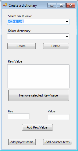

' Postconditions:
' 1. Displays a dialog.
' 2. Select a vault.
' 3. Select the Projects dictionary.
'    a. Click Create.
'    b. Click Add project items.
'       The Key/Value list is populated with the
'       Projects dictionary's keys and values.
'    c. Type a unique value in Key and any value in Value.
'    d. Click Add Key/Value.
'       The key and value are added to the Key/Value list.
'    e. Select a key and value in the Key/Value list and
'       click Remove selected Key/Value.
'       The selected key and value are deleted from the
'       dictionary.
'    f. Type an existing key in Key and any value in Value.
'    g. Click Add Key/Value.
'       A message box is displayed informing you that the
'       duplicate keys are prohibited. Neither the key
'       nor value was added to the dictionary.
'    h. Click OK to close the message box.
' 4. Select the Counters dictionary.
'    a. Click Create.
'    b. Click Add counter items.
'       The Key/Value list is populated with the Counters
'       dictionary's keys and values.
' 5. Experiment with creating your own dictionary and adding
'    and removing keys and values to and from that dictionary.
' 6. Close the dialog.

      Handles AddCounterItemsButton.Click
        Try
            If Not vault.IsLoggedIn Then
                'Log into selected vault as the current user
                vault.LoginAuto(VaultsComboBox.Text, _
                   Me.Handle.ToInt32())
            End If
            Dim CounterDictionary As IEdmDictionary5
            CounterDictionary = vault.GetDictionary _
              ("Counters"True'Create it, if it doesn't exist
            'Add the new dictionary name to the list box,
            'if it doesn't exist
            If Not DictionaryComboBox.Items.Contains( _
                "Counters"Then
                DictionaryComboBox.Items.Add("Counters")
            End If
            Dim SuccessSet As Boolean = False
            SuccessSet = CounterDictionary.StringTestAndSetAt _
              ("Electric""5")
              ("Hybrid""10")
              ("Gasoline""15")
              ("Diesel""20")
            If DictionaryComboBox.Text = "Counters" Then
                DisplayDictionaryItems("Counters", _
                  CounterDictionary, KeyValueListBox)
            Else
            End If
        Catch ex As Runtime.InteropServices.COMException
            MessageBox.Show("HRESULT = 0x" + _
            ex.ErrorCode.ToString("X") + vbCrLf + _
            ex.Message)
        Catch ex As Exception
            MessageBox.Show(ex.Message)
        End Try
    End Sub
    Private Sub DisplayDictionaryItems( _
      ByVal DictionaryName As String, _
      ByVal Dictionary As IEdmDictionary5, _
      ByVal ListObject As Object)
        Try
            ListObject.Items.Clear()
            If Dictionary Is Nothing Then
                ListObject.Items.Add(DictionaryComboBox.Text + _
                  " dictionary doesn't exist.")
            Else
                'Traverse and display the Key/Value pairs
                'in the dictionary
                Dim Key As String = ""
                Dim Value As String = ""
                Dim Pos As IEdmPos5
                Pos = Dictionary.StringGetFirstPosition()
                While Not Pos.IsNull
                    Dictionary.StringGetNextAssoc(Pos, Key, Value)
                    ListObject.Items.Add(Key + vbTab + Value)
                End While
            End If
            ex.Message)
        End Try
    End Sub
End Class
'Form1.Designer.vb
<Global.Microsoft.VisualBasic.CompilerServices.DesignerGenerated()> _
Partial Class AddDictionary
   Inherits System.Windows.Forms.Form
   'Form overrides dispose to clean up the component list.
   <System.Diagnostics.DebuggerNonUserCode()> _
   Protected Overrides Sub Dispose(ByVal disposing As Boolean)
      Try
         If disposing AndAlso components IsNot Nothing Then
            components.Dispose()
         End If
      Finally
         MyBase.Dispose(disposing)
      End Try
   End Sub
   'Required by the Windows Form Designer
   Private components As System.ComponentModel.IContainer
   'NOTE: The following procedure is required by the Windows Form Designer
   'It can be modified using the Windows Form Designer.
   'Do not modify it using the code editor.
   <System.Diagnostics.DebuggerStepThrough()> _
   Private Sub InitializeComponent()
        Me.VaultsComboBox = New System.Windows.Forms.ComboBox()
        Me.VaultsLabel = New System.Windows.Forms.Label()
        Me.AddProjectItemsButton = New System.Windows.Forms.Button()
        Me.DictionaryComboBox = New System.Windows.Forms.ComboBox()
        Me.DictionaryLabel = New System.Windows.Forms.Label()
        Me.KeyValueListBox = New System.Windows.Forms.ListBox()
        Me.KeyValueLabel = New System.Windows.Forms.Label()
        Me.CreateButton = New System.Windows.Forms.Button()
        Me.DeleteButton = New System.Windows.Forms.Button()
        Me.KeyTextBox = New System.Windows.Forms.TextBox()
        Me.ValueTextBox = New System.Windows.Forms.TextBox()
        Me.KeyLabel = New System.Windows.Forms.Label()
        Me.ValueLabel = New System.Windows.Forms.Label()
        Me.AddKeyValueButton = New System.Windows.Forms.Button()
        Me.RemoveButton = New System.Windows.Forms.Button()
        Me.AddCounterItemsButton = New System.Windows.Forms.Button()
        Me.SuspendLayout()
        'VaultsComboBox
        Me.VaultsComboBox.FormattingEnabled = True
        Me.VaultsComboBox.Location = New System.Drawing.Point(17, 35)
        Me.VaultsComboBox.Margin = New System.Windows.Forms.Padding(2)
        Me.VaultsComboBox.Name = "VaultsComboBox"
        Me.VaultsComboBox.Size = New System.Drawing.Size(218, 21)
        Me.VaultsComboBox.TabIndex = 14
        'VaultsLabel
        Me.VaultsLabel.AutoSize = True
        Me.VaultsLabel.Location = New System.Drawing.Point(17, 19)
        Me.VaultsLabel.Margin = New System.Windows.Forms.Padding(2, 0, 2, 0)
        Me.VaultsLabel.Name = "VaultsLabel"
        Me.VaultsLabel.Size = New System.Drawing.Size(91, 13)
        Me.VaultsLabel.TabIndex = 15
        Me.VaultsLabel.Text = "Select vault view:"
        'AddProjectItemsButton
        Me.AddProjectItemsButton.Location = New System.Drawing.Point(20, 451)
        Me.AddProjectItemsButton.Margin = New System.Windows.Forms.Padding(2)
        Me.AddProjectItemsButton.Name = "AddProjectItemsButton"
        Me.AddProjectItemsButton.Size = New System.Drawing.Size(98, 24)
        Me.AddProjectItemsButton.TabIndex = 16
        Me.AddProjectItemsButton.Text = "Add project items"
        Me.AddProjectItemsButton.UseVisualStyleBackColor = True
        'DictionaryComboBox
        Me.DictionaryComboBox.FormattingEnabled = True
        Me.DictionaryComboBox.Items.AddRange(New Object() {"Projects""Counters"})
        Me.DictionaryComboBox.Location = New System.Drawing.Point(17, 86)
        Me.DictionaryComboBox.Margin = New System.Windows.Forms.Padding(2)
        Me.DictionaryComboBox.Name = "DictionaryComboBox"
        Me.DictionaryComboBox.Size = New System.Drawing.Size(218, 21)
        Me.DictionaryComboBox.TabIndex = 17
        'DictionaryLabel
        Me.DictionaryLabel.AutoSize = True
        Me.DictionaryLabel.Location = New System.Drawing.Point(17, 70)
        Me.DictionaryLabel.Margin = New System.Windows.Forms.Padding(2, 0, 2, 0)
        Me.DictionaryLabel.Name = "DictionaryLabel"
        Me.DictionaryLabel.Size = New System.Drawing.Size(88, 13)
        Me.DictionaryLabel.TabIndex = 18
        Me.DictionaryLabel.Text = "Select dictionary:"
        'KeyValueListBox
        Me.KeyValueListBox.FormattingEnabled = True
        Me.KeyValueListBox.Location = New System.Drawing.Point(17, 194)
        Me.KeyValueListBox.Margin = New System.Windows.Forms.Padding(2)
        Me.KeyValueListBox.Name = "KeyValueListBox"
        Me.KeyValueListBox.Size = New System.Drawing.Size(218, 82)
        Me.KeyValueListBox.TabIndex = 19
        'KeyValueLabel
        Me.KeyValueLabel.AutoSize = True
        Me.KeyValueLabel.Location = New System.Drawing.Point(17, 176)
        Me.KeyValueLabel.Margin = New System.Windows.Forms.Padding(2, 0, 2, 0)
        Me.KeyValueLabel.Name = "KeyValueLabel"
        Me.KeyValueLabel.Size = New System.Drawing.Size(57, 13)
        Me.KeyValueLabel.TabIndex = 20
        Me.KeyValueLabel.Text = "Key/Value"
        'CreateButton
        Me.CreateButton.Location = New System.Drawing.Point(17, 118)
        Me.CreateButton.Margin = New System.Windows.Forms.Padding(2)
        Me.CreateButton.Name = "CreateButton"
        Me.CreateButton.Size = New System.Drawing.Size(101, 24)
        Me.CreateButton.TabIndex = 21
        Me.CreateButton.Text = "Create"
        Me.CreateButton.UseVisualStyleBackColor = True
        'DeleteButton
        Me.DeleteButton.Location = New System.Drawing.Point(142, 118)
        Me.DeleteButton.Margin = New System.Windows.Forms.Padding(2)
        Me.DeleteButton.Name = "DeleteButton"
        Me.DeleteButton.Size = New System.Drawing.Size(93, 24)
        Me.DeleteButton.TabIndex = 22
        Me.DeleteButton.Text = "Delete"
        Me.DeleteButton.UseVisualStyleBackColor = True
        'KeyTextBox
        Me.KeyTextBox.Location = New System.Drawing.Point(20, 364)
        Me.KeyTextBox.Margin = New System.Windows.Forms.Padding(2)
        Me.KeyTextBox.Name = "KeyTextBox"
        Me.KeyTextBox.Size = New System.Drawing.Size(76, 20)
        Me.KeyTextBox.TabIndex = 23
        'ValueTextBox
        Me.ValueTextBox.Location = New System.Drawing.Point(159, 366)
        Me.ValueTextBox.Margin = New System.Windows.Forms.Padding(2)
        Me.ValueTextBox.Name = "ValueTextBox"
        Me.ValueTextBox.Size = New System.Drawing.Size(76, 20)
        Me.ValueTextBox.TabIndex = 24
        'KeyLabel
        Me.KeyLabel.AutoSize = True
        Me.KeyLabel.Location = New System.Drawing.Point(17, 349)
        Me.KeyLabel.Margin = New System.Windows.Forms.Padding(2, 0, 2, 0)
        Me.KeyLabel.Name = "KeyLabel"
        Me.KeyLabel.Size = New System.Drawing.Size(25, 13)
        Me.KeyLabel.TabIndex = 25
        Me.KeyLabel.Text = "Key"
        'ValueLabel
        Me.ValueLabel.AutoSize = True
        Me.ValueLabel.Location = New System.Drawing.Point(156, 349)
        Me.ValueLabel.Margin = New System.Windows.Forms.Padding(2, 0, 2, 0)
        Me.ValueLabel.Name = "ValueLabel"
        Me.ValueLabel.Size = New System.Drawing.Size(34, 13)
        Me.ValueLabel.TabIndex = 26
        Me.ValueLabel.Text = "Value"
        'AddKeyValueButton
        Me.AddKeyValueButton.Location = New System.Drawing.Point(68, 399)
        Me.AddKeyValueButton.Margin = New System.Windows.Forms.Padding(2)
        Me.AddKeyValueButton.Name = "AddKeyValueButton"
        Me.AddKeyValueButton.Size = New System.Drawing.Size(110, 25)
        Me.AddKeyValueButton.TabIndex = 27
        Me.AddKeyValueButton.Text = "Add Key/Value"
        Me.AddKeyValueButton.UseVisualStyleBackColor = True
        'RemoveButton
        Me.RemoveButton.Location = New System.Drawing.Point(20, 280)
        Me.RemoveButton.Margin = New System.Windows.Forms.Padding(2)
        Me.RemoveButton.Name = "RemoveButton"
        Me.RemoveButton.Size = New System.Drawing.Size(215, 41)
        Me.RemoveButton.TabIndex = 28
        Me.RemoveButton.Text = "Remove selected Key/Value"
        Me.RemoveButton.UseVisualStyleBackColor = True
        'AddCounterItemsButton
        Me.AddCounterItemsButton.Location = New System.Drawing.Point(142, 451)
        Me.AddCounterItemsButton.Margin = New System.Windows.Forms.Padding(2)
        Me.AddCounterItemsButton.Name = "AddCounterItemsButton"
        Me.AddCounterItemsButton.Size = New System.Drawing.Size(104, 24)
        Me.AddCounterItemsButton.TabIndex = 29
        Me.AddCounterItemsButton.Text = "Add counter items"
        Me.AddCounterItemsButton.UseVisualStyleBackColor = True
        'AddDictionary
        Me.AutoScaleDimensions = New System.Drawing.SizeF(6.0!, 13.0!)
        Me.AutoScaleMode = System.Windows.Forms.AutoScaleMode.Font
        Me.ClientSize = New System.Drawing.Size(257, 486)
        Me.Controls.Add(Me.AddCounterItemsButton)
        Me.Controls.Add(Me.RemoveButton)
        Me.Controls.Add(Me.AddKeyValueButton)
        Me.Controls.Add(Me.ValueLabel)
        Me.Controls.Add(Me.KeyLabel)
        Me.Controls.Add(Me.ValueTextBox)
        Me.Controls.Add(Me.KeyTextBox)
        Me.Controls.Add(Me.DeleteButton)
        Me.Controls.Add(Me.CreateButton)
        Me.Controls.Add(Me.KeyValueLabel)
        Me.Controls.Add(Me.KeyValueListBox)
        Me.Controls.Add(Me.DictionaryComboBox)
        Me.Controls.Add(Me.DictionaryLabel)
        Me.Controls.Add(Me.AddProjectItemsButton)
        Me.Controls.Add(Me.VaultsComboBox)
        Me.Controls.Add(Me.VaultsLabel)
        Me.Margin = New System.Windows.Forms.Padding(2)
        Me.Name = "AddDictionary"
        Me.Text = "Create a dictionary"
        Me.ResumeLayout(False)
        Me.PerformLayout()
    End Sub
   Friend WithEvents VaultsComboBox As System.Windows.Forms.ComboBox
   Friend WithEvents VaultsLabel As System.Windows.Forms.Label
   Friend WithEvents AddProjectItemsButton As System.Windows.Forms.Button
   Friend WithEvents DictionaryComboBox As System.Windows.Forms.ComboBox
   Friend WithEvents DictionaryLabel As System.Windows.Forms.Label
   Friend WithEvents KeyValueListBox As System.Windows.Forms.ListBox
   Friend WithEvents KeyValueLabel As System.Windows.Forms.Label
   Friend WithEvents CreateButton As System.Windows.Forms.Button
   Friend WithEvents DeleteButton As System.Windows.Forms.Button
   Friend WithEvents KeyTextBox As System.Windows.Forms.TextBox
   Friend WithEvents ValueTextBox As System.Windows.Forms.TextBox
   Friend WithEvents KeyLabel As System.Windows.Forms.Label
   Friend WithEvents ValueLabel As System.Windows.Forms.Label
   Friend WithEvents AddKeyValueButton As System.Windows.Forms.Button
   Friend WithEvents RemoveButton As System.Windows.Forms.Button
   Friend WithEvents AddCounterItemsButton As System.Windows.Forms.Button
End Class
