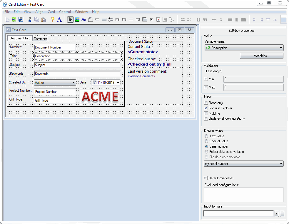

  10. Click Cards > File Cards, double-click Text Card, and click the Title control.
  11. In the Default value group box on the Edit-box properties panel, click Serial number and select the serial number that you created in step 7.
  12.
  13. Save the card and exit the Card Editor.
