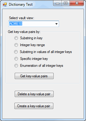

Get and Set Dictionary Key-Value Pairs Example (C#)
This example shows how to access key-value pairs in a vault dictionary.

// Postconditions:
//  1. Displays a dialog.
//  2. Select a vault view.
//  3. Click Substring in key.
//  4. Click Get key-value pairs.
//     a. Displays a message box with all key-value pairs in the dictionary where
//        string key contains "at".
//     b. Click OK.
//  5. Click Integer key range.
//  6. Click Get key-value pairs.
//        integer keys are in the range, 13-88.
//     b. Click OK.
//  7. Click Substring in values of all integer keys.
//  8. Click Get key-value pairs.
//        value contains "three".
//     b. Click OK.
//  9. Click Specific integer key.
// 10. Click Get key-value pairs.
//     a. Displays a message box with the value for key, 77.
//     b. Click OK.
// 11. Click Enumeration of all integer keys.
// 12. Click Get key-value pairs.
//     a. Displays a message box with all integer key-value pairs in the dictionary.
//     b. Click OK.
// 13. Click Delete a key-value pair.
//     a. Displays a message box notifying that key, 2, is removed.
//     b. Click OK.
// 14. Click Create a key-value pair.
//     a. Displays a message box notifying that key, 2, is created.
//     b. Click OK.
// 15. Close the dialog.

            this.RadioButton4 = new System.Windows.Forms.RadioButton();
            this.RadioButton5 = new System.Windows.Forms.RadioButton();
            this.Button1 = new System.Windows.Forms.Button();
            this.GroupBox1 = new System.Windows.Forms.GroupBox();
            this.GroupBox1.SuspendLayout();
            this.SuspendLayout();
            // VaultsComboBox
            this.VaultsComboBox.FormattingEnabled = true;
            this.VaultsComboBox.Location = new System.Drawing.Point(20, 39);
            this.VaultsComboBox.Name = "VaultsComboBox";
            this.VaultsComboBox.Size = new System.Drawing.Size(169, 21);
            this.VaultsComboBox.TabIndex = 1;
            // Label1
            this.Label1.AutoSize = true;
            this.Label1.Location = new System.Drawing.Point(19, 23);
            this.Label1.Name = "Label1";
            this.Label1.Size = new System.Drawing.Size(91, 13);
            this.Label1.TabIndex = 2;
            this.Label1.Text = "Select vault view:";
            // Button5
            this.Button5.Location = new System.Drawing.Point(40, 272);
            this.Button5.Name = "Button5";
            this.Button5.Size = new System.Drawing.Size(132, 23);
            this.Button5.TabIndex = 7;
            this.Button5.Text = "Delete a key-value pair";
            this.Button5.UseVisualStyleBackColor = true;
            this.Button5.Click += new System.EventHandler(this.Button5_Click);
            // Button7
            this.Button7.Location = new System.Drawing.Point(39, 312);
            this.Button7.Name = "Button7";
            this.Button7.Size = new System.Drawing.Size(132, 23);
            this.Button7.TabIndex = 9;
            this.Button7.Text = "Create a key-value pair";
            this.Button7.UseVisualStyleBackColor = true;
            this.Button7.Click += new System.EventHandler(this.Button7_Click);
            // RadioButton1
            this.RadioButton1.AutoSize = true;
            this.RadioButton1.Location = new System.Drawing.Point(30, 19);
            this.RadioButton1.Name = "RadioButton1";
            this.RadioButton1.Size = new System.Drawing.Size(100, 17);
            this.RadioButton1.TabIndex = 11;
            this.RadioButton1.Text = "Substring in key";
            this.RadioButton1.UseVisualStyleBackColor = true;
            // RadioButton2
            this.RadioButton2.AutoSize = true;
            this.RadioButton2.Location = new System.Drawing.Point(30, 42);
            this.RadioButton2.Name = "RadioButton2";
            this.RadioButton2.Size = new System.Drawing.Size(108, 17);
            this.RadioButton2.TabIndex = 12;
            this.RadioButton2.TabStop = true;
            this.RadioButton2.Text = "Integer key range";
            this.RadioButton2.UseVisualStyleBackColor = true;
            // RadioButton3
            this.RadioButton3.AutoSize = true;
            this.RadioButton3.Location = new System.Drawing.Point(29, 65);
            this.RadioButton3.Name = "RadioButton3";
            this.RadioButton3.Size = new System.Drawing.Size(199, 17);
            this.RadioButton3.TabIndex = 13;
            this.RadioButton3.TabStop = true;
            this.RadioButton3.Text = "Substring in values of all integer keys";
            this.RadioButton3.UseVisualStyleBackColor = true;
            // RadioButton4
            this.RadioButton4.AutoSize = true;
            this.RadioButton4.Location = new System.Drawing.Point(30, 88);
            this.RadioButton4.Name = "RadioButton4";
            this.RadioButton4.Size = new System.Drawing.Size(118, 17);
            this.RadioButton4.TabIndex = 14;
            this.RadioButton4.TabStop = true;
            this.RadioButton4.Text = "Specific integer key";
            this.RadioButton4.UseVisualStyleBackColor = true;
            // RadioButton5
            this.RadioButton5.AutoSize = true;
            this.RadioButton5.Location = new System.Drawing.Point(30, 111);
            this.RadioButton5.Name = "RadioButton5";
            this.RadioButton5.Size = new System.Drawing.Size(169, 17);
            this.RadioButton5.TabIndex = 15;
            this.RadioButton5.TabStop = true;
            this.RadioButton5.Text = "Enumeration of all integer keys";
            this.RadioButton5.UseVisualStyleBackColor = true;
            // Button1
            this.Button1.Location = new System.Drawing.Point(30, 143);
            this.Button1.Name = "Button1";
            this.Button1.Size = new System.Drawing.Size(132, 23);
            this.Button1.TabIndex = 16;
            this.Button1.Text = "Get key-value pairs";
            this.Button1.UseVisualStyleBackColor = true;
            this.Button1.Click += new System.EventHandler(this.Button1_Click);
            // GroupBox1
            this.GroupBox1.Controls.Add(this.Button1);
            this.GroupBox1.Controls.Add(this.RadioButton5);
            this.GroupBox1.Controls.Add(this.RadioButton4);
            this.GroupBox1.Controls.Add(this.RadioButton3);
            this.GroupBox1.Controls.Add(this.RadioButton2);
            this.GroupBox1.Controls.Add(this.RadioButton1);
            this.GroupBox1.Location = new System.Drawing.Point(10, 69);
            this.GroupBox1.Name = "GroupBox1";
            this.GroupBox1.Size = new System.Drawing.Size(249, 181);
            this.GroupBox1.TabIndex = 17;
            this.GroupBox1.TabStop = false;
            this.GroupBox1.Text = "Get key-value pairs by:";
            // Form1
            this.AutoScaleDimensions = new System.Drawing.SizeF(6F, 13F);
            this.AutoScaleMode = System.Windows.Forms.AutoScaleMode.Font;
            this.ClientSize = new System.Drawing.Size(271, 366);
            this.Controls.Add(this.GroupBox1);
            this.Controls.Add(this.Button7);
            this.Controls.Add(this.Button5);
            this.Controls.Add(this.Label1);
            this.Controls.Add(this.VaultsComboBox);
            this.Name = "Form1";
            this.Text = "Dictionary Test";
            this.Load += new System.EventHandler(this.Form1_Load);
            this.GroupBox1.ResumeLayout(false);
            this.GroupBox1.PerformLayout();
            this.ResumeLayout(false);
            this.PerformLayout();
        internal System.Windows.Forms.ComboBox VaultsComboBox;
        internal System.Windows.Forms.Label Label1;
        internal System.Windows.Forms.Button Button5;
        internal System.Windows.Forms.Button Button7;
        internal System.Windows.Forms.RadioButton RadioButton1;
        internal System.Windows.Forms.RadioButton RadioButton2;
        internal System.Windows.Forms.RadioButton RadioButton3;
        internal System.Windows.Forms.RadioButton RadioButton4;
        internal System.Windows.Forms.RadioButton RadioButton5;
        internal System.Windows.Forms.Button Button1;
        internal System.Windows.Forms.GroupBox GroupBox1;
