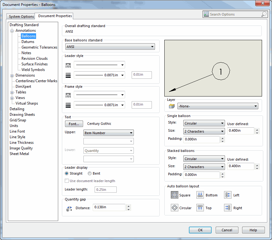

Document Properties > Annotations > Balloons
Setting
Get/Set Methods
Return Value or <Value>
Comments
Base balloons standard
IModelDocExtension::GetUserPreferenceInteger(swUserPreferenceIntegerValue_e.swDetailingDimensionStandard, swUserPreferenceOption_e.swDetailingBalloon)
IModelDocExtension::SetUserPreferenceInteger(swUserPreferenceIntegerValue_e.swDetailingDimensionStandard, swUserPreferenceOption_e.swDetailingBalloon, swDetailingStandard_e.<Value>)
See swDetailingStandard_e for valid options
Specifies the base balloons standard to use
Leader style - Leader Style
IModelDocExtension::GetUserPreferenceInteger(swUserPreferenceIntegerValue_e.swDetailingBalloonLeaderLineStyle, swUserPreferenceOption_e.swDetailingBalloon)
IModelDocExtension::SetUserPreferenceInteger(swUserPreferenceIntegerValue_e.swDetailingBalloonLeaderLineStyle, swUserPreferenceOption_e.swDetailingBalloon, swLineStyles_e.<Value>)
See swLineStyles_e for valid options
Leader style - Leader Thickness
IModelDocExtension::GetUserPreferenceInteger(swUserPreferenceIntegerValue_e.swDetailingBalloonLeaderLineThickness, swUserPreferenceOption_e.swDetailingBalloon)
IModelDocExtension::SetUserPreferenceInteger(swUserPreferenceIntegerValue_e.swDetailingBalloonLeaderLineThickness, swUserPreferenceOption_e.swDetailingBalloon, swLineWeights_e.<Value>)
See swLineWeights_e for valid options
Specifies the default style of unattached dimension arrows
Leader style - Custom thickness
IModelDocExtension::GetUserPreferenceDouble(swUserPreferenceDoubleValue_e.swDetailingBalloonLeaderLineThicknessCustom, swUserPreferenceOption_e.swDetailingBalloon)
IModelDocExtension::SetUserPreferenceDouble(swUserPreferenceDoubleValue_e.swDetailingBalloonLeaderLineThicknessCustom, swUserPreferenceOption_e.swDetailingBalloon, <Value>)
Double value
Specifies custom thickness for balloon leader lines; sets Custom Thickness to the specified thickness and Leader Thickness to Custom Size
Frame style - Frame Style
IModelDocExtension::GetUserPreferenceInteger(swUserPreferenceIntegerValue_e.swDetailingBalloonFrameLineStyle, swUserPreferenceOption_e.swDetailingBalloon)
IModelDocExtension::SetUserPreferenceInteger(swUserPreferenceIntegerValue_e.swDetailingBalloonFrameLineStyle, swUserPreferenceOption_e.swDetailingBalloon, swLineStyles_e .<Value>)
Specifies the length of the annotation bend leaders in a drawing document
Frame style -  Frame Thickness
IModelDocExtension::GetUserPreferenceInteger(swUserPreferenceIntegerValue_e.swDetailingBalloonFrameLineThickness, swUserPreferenceOption_e.swDetailingBalloon)
IModelDocExtension::SetUserPreferenceInteger(swUserPreferenceIntegerValue_e.swDetailingBalloonFrameLineThickness, swUserPreferenceOption_e.swDetailingBalloon, swLineWeights_e.<Value>)
Frame style - custom thickness
IModelDocExtension::GetUserPreferenceDouble(swUserPreferenceDoubleValue_e.swDetailingBalloonFrameLineThicknessCustom, swUserPreferenceOption_e.swDetailingBalloon)
IModelDocExtension::SetUserPreferenceDouble(swUserPreferenceDoubleValue_e.swDetailingBalloonFrameLineThicknessCustom, swUserPreferenceOption_e.swDetailingBalloon, <Value>)
Double value
Specifies custom thickness for balloon frame lines; sets Custom Thickness to the specified thickness and Leader Thickness to Custom Size
Text - Font...
IModelDocExtension::GetUserPreferenceTextFormat(swUserPreferenceTextFormat_e.swDetailingBalloonTextFormat, swUserPreferenceOption_e.swDetailingBalloon)
IModelDocExtension::SetUserPreferenceTextFormat(swUserPreferenceTextFormat_e.swDetailingBalloonTextFormat, swUserPreferenceOption_e.swDetailingBalloon, <Value>)
See ITextFormat for valid font options
To set font property values, implement ITextFormat, set the appropriate ITextFormat member values, and pass the ITextFormat object in the API set method
Text - Upper
IModelDocExtension::GetUserPreferenceInteger(swUserPreferenceIntegerValue_e.swDetailingBOMUpperText, swUserPreferenceOption_e.swDetailingBalloon)
IModelDocExtension::SetUserPreferenceInteger(swUserPreferenceIntegerValue_e.swDetailingBOMUpperText, swUserPreferenceOption_e.swDetailingBalloon, swBalloonTextContent_e.<Value>)
See swBalloonTextContent_e for valid options
Specifies the upper section of the text of BOM balloons
Text - Upper - Custom property
IModelDocExtension::GetUserPreferenceString(swUserPreferenceStringValue_e.swDetailingBOMUpperCustomProperty, swUserPreferenceOption_e.swDetailingBalloon)
IModelDocExtension::SetUserPreferenceString(swUserPreferenceStringValue_e.swDetailingBOMUpperCustomProperty, swUserPreferenceOption_e.swDetailingBalloon, <Value>)
String value
Text - Lower
IModelDocExtension::GetUserPreferenceInteger(swUserPreferenceIntegerValue_e.swDetailingBOMLowerText, swUserPreferenceOption_e.swDetailingBalloon)
IModelDocExtension::SetUserPreferenceInteger(swUserPreferenceIntegerValue_e.swDetailingBOMLowerText, swUserPreferenceOption_e.swDetailingBalloon, swBalloonTextContent_e.<Value>)
Specifies the lower section of the text of BOM balloons
Text - Lower - Custom property
IModelDocExtension::GetUserPreferenceString(swUserPreferenceStringValue_e.swDetailingBOMLowerCustomProperty, swUserPreferenceOption_e.swDetailingBalloon)
IModelDocExtension::SetUserPreferenceString(swUserPreferenceStringValue_e.swDetailingBOMLowerCustomProperty, swUserPreferenceOption_e.swDetailingBalloon, <Value>)
String value
Leader display - style
IModelDocExtension::GetUserPreferenceInteger(swUserPreferenceIntegerValue_e.swDetailingBalloonLeaderStyle, swUserPreferenceOption_e.swDetailingBalloon)
IModelDocExtension::SetUserPreferenceInteger(swUserPreferenceIntegerValue_e.swDetailingBalloonLeaderStyle, swUserPreferenceOption_e.swDetailingBalloon, swLeaderStyle_e.<Value>)
See swLeaderStyle_e for valid options
Leader display - Use document leader length
IModelDocExtension::GetUserPreferenceToggle(swUserPreferenceToggle_e.swDetailingBalloonUseBentLeaderLength, swUserPreferenceOption_e.swDetailingBalloon)
IModelDocExtension::SetUserPreferenceToggle(swUserPreferenceToggle_e.swDetailingBalloonUseBentLeaderLength, swUserPreferenceOption_e.swDetailingBalloon, <Value>)
Boolean value
Specifies whether to use bent leaders for annotations
Leader display - Leader length
IModelDocExtension::GetUserPreferenceDouble(swUserPreferenceDoubleValue_e.swDetailingBalloonBentLeaderLength, swUserPreferenceOption_e.swDetailingBalloon)
IModelDocExtension::SetUserPreferenceDouble(swUserPreferenceDoubleValue_e.swDetailingBalloonBentLeaderLength, swUserPreferenceOption_e.swDetailingBalloon, <Value>)
Double value
Specifies length of the balloon bent leader
Quantity gap - Distance
IModelDocExtension::GetUserPreferenceDouble(swUserPreferenceDoubleValue_e.swDetailingBalloonQtyGapDistance, swUserPreferenceOption_e.swDetailingBalloon)
IModelDocExtension::SetUserPreferenceDouble(swUserPreferenceDoubleValue_e.swDetailingBalloonQtyGapDistance, swUserPreferenceOption_e.swDetailingBalloon, <Value>)
Double value
Specifies the distance between the balloon edge and the quantity
Layer
IModelDocExtension::GetUserPreferenceString(swUserPreferenceStringValue_e.swDetailingLayer, swUserPreferenceOption_e.swDetailingBalloon)
IModelDocExtension::SetUserPreferenceString(swUserPreferenceStringValue_e.swDetailingLayer, swUserPreferenceOption_e.swDetailingBalloon, <Value>)
String value
Specifies the name of the layer to apply these settings to; this setting is available only on drawings
Single balloon - Style
IModelDocExtension::GetUserPreferenceInteger(swUserPreferenceIntegerValue_e.swDetailingBOMBalloonStyle, swUserPreferenceOption_e.swDetailingBalloon)
IModelDocExtension::SetUserPreferenceInteger(swUserPreferenceIntegerValue_e.swDetailingBOMBalloonStyle, swUserPreferenceOption_e.swDetailingBalloon, swBalloonStyle_e.<Value>)
See swBalloonStyle_e for valid options
Specifies shape of single BOM balloon
Single balloon - Size
IModelDocExtension::GetUserPreferenceInteger(swUserPreferenceIntegerValue_e.swDetailingBOMBalloonFit, swUserPreferenceOption_e.swDetailingBalloon)
IModelDocExtension::SetUserPreferenceInteger(swUserPreferenceIntegerValue_e.swDetailingBOMBalloonFit, swUserPreferenceOption_e.swDetailingBalloon, swBalloonFit_e.<Value>)
See swBalloonFit_e for valid options
Specifies size of single BOM balloon
Single balloon - User defined
IModelDocExtension::GetUserPreferenceDouble(swUserPreferenceDoubleValue_e.swDetailingBOMBalloonCustomSize, swUserPreferenceOption_e.swDetailingBalloon)
IModelDocExtension::SetUserPreferenceDouble(swUserPreferenceDoubleValue_e.swDetailingBOMBalloonCustomSize, swUserPreferenceOption_e.swDetailingBalloon, <Value>)
Double value
Specifies the custom size of a single BOM balloon; sets the Size spin box to the specified size and the Size dropdown to Custom Size
Single balloon - Padding
IModelDocExtension::GetUserPreferenceDouble(swUserPreferenceDoubleValue_e.swDetailingBOMBalloonPadding, swUserPreferenceOption_e.swDetailingBalloon)
IModelDocExtension::SetUserPreferenceDouble(swUserPreferenceDoubleValue_e.swDetailingBOMBalloonPadding, swUserPreferenceOption_e.swDetailingBalloon, <Value>)
Double value
Specifies the padding for single BOM balloons
Stacked balloons - Style
IModelDocExtension::GetUserPreferenceInteger(swUserPreferenceIntegerValue_e.swDetailingBOMStackedBalloonStyle, swUserPreferenceOption_e.swDetailingBalloon)
IModelDocExtension::SetUserPreferenceInteger(swUserPreferenceIntegerValue_e.swDetailingBOMStackedBalloonStyle, swUserPreferenceOption_e.swDetailingBalloon, swBalloonStyle_e.<Value>)
Specifies the shapes of stacked BOM balloons
Stacked balloons - Size
IModelDocExtension::GetUserPreferenceInteger(swUserPreferenceIntegerValue_e.swDetailingBOMStackedBalloonFit, swUserPreferenceOption_e.swDetailingBalloon)
IModelDocExtension::SetUserPreferenceInteger(swUserPreferenceIntegerValue_e.swDetailingBOMStackedBalloonFit, swUserPreferenceOption_e.swDetailingBalloon, swBalloonFit_e.<Value>)
Specifies the sizes of stacked BOM balloons
Stacked balloons - User defined
IModelDocExtension::GetUserPreferenceDouble(swUserPreferenceDoubleValue_e.swDetailingBOMStackedBalloonCustomSize, swUserPreferenceOption_e.swDetailingBalloon)
IModelDocExtension::SetUserPreferenceDouble(swUserPreferenceDoubleValue_e.swDetailingBOMStackedBalloonCustomSize, swUserPreferenceOption_e.swDetailingBalloon, <Value>)
Double value
Specifies the custom sizes of stacked BOM balloons; sets the Size spin box to the specified size and the Size dropdown to Custom Size
Stacked balloons - Padding
IModelDocExtension::GetUserPreferenceDouble(swUserPreferenceDoubleValue_e.swDetailingBOMStackedBalloonPadding, swUserPreferenceOption_e.swDetailingBalloon)
IModelDocExtension::SetUserPreferenceDouble(swUserPreferenceDoubleValue_e.swDetailingBOMStackedBalloonPadding, swUserPreferenceOption_e.swDetailingBalloon, <Value>)
Double value
Specifies the padding for stacked BOM balloons
Auto balloon layout
IModelDocExtension::GetUserPreferenceInteger(swUserPreferenceIntegerValue_e.swDetailingAutoBalloonLayout, swUserPreferenceOption_e.swDetailingBalloon)
IModelDocExtension::SetUserPreferenceInteger(swUserPreferenceIntegerValue_e.swDetailingAutoBalloonLayout, swUserPreferenceOption_e.swDetailingBalloon, swBalloonLayoutType_e.<Value>)
See swBalloonLayoutType_e for valid options
Specifies default auto balloon layout
