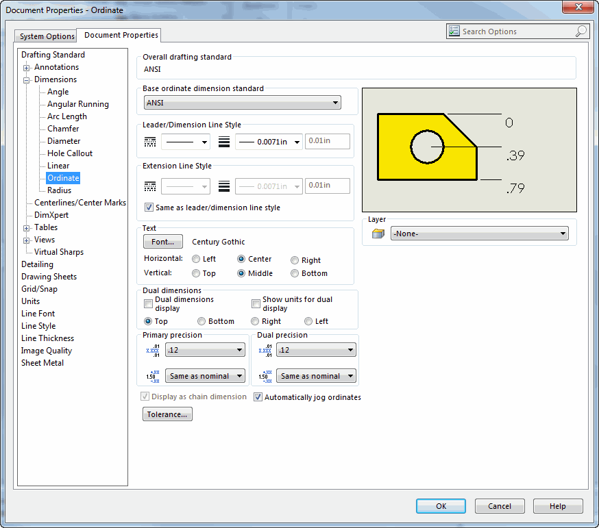

Document Properties > Dimensions > Ordinate
Setting
Get/Set Methods
Return Value or <Value>
Comments
Base ordinate dimension standard
IModelDocExtension::GetUserPreferenceInteger(swUserPreferenceIntegerValue_e.swDetailingDimensionStandard, swUserPreferenceOption_e.swDetailingOrdinateDimension)
IModelDocExtension::SetUserPreferenceInteger(swUserPreferenceIntegerValue_e.swDetailingDimensionStandard, swUserPreferenceOption_e.swDetailingOrdinateDimension, swDetailingStandard_e.<Value>)
See swDetailingStandard_e for valid options
Specifies the base ordinate dimensioning standard to use

Display as chain dimension
IModelDocExtension::GetUserPreferenceToggle(swUserPreferenceToggle_e.swDetailingOrdinateDisplayAsChain, swUserPreferenceOption_e.swDetailingNoOptionSpecified)
IModelDocExtension::SetUserPreferenceToggle(swUserPreferenceToggle_e.swDetailingOrdinateDisplayAsChain, swUserPreferenceOption_e.swDetailingNoOptionSpecified, <Value>)
Boolean value
Specifies whether to display ordinate dimension as chain dimension
Automatically jog ordinates
IModelDocExtension::GetUserPreferenceToggle(swUserPreferenceToggle_e.swDetailingDimsAutoJogOrdinates, swUserPreferenceOption_e.swDetailingNoOptionSpecified)
IModelDocExtension::SetUserPreferenceToggle(swUserPreferenceToggle_e.swDetailingDimsAutoJogOrdinates, swUserPreferenceOption_e.swDetailingNoOptionSpecified, <Value>)
Boolean value
Specifies whether to automatically jog ordinates
Tolerance...
See Comments
See Comments
See Dimension Tolerance
