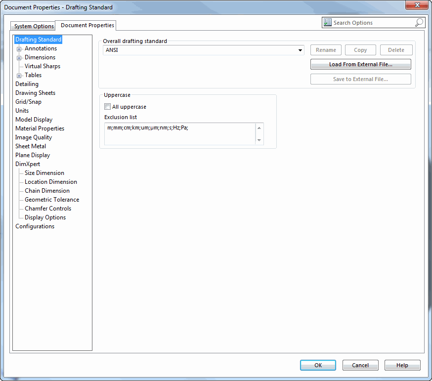

Document Properties > Drafting Standard
Setting
Get/Set Methods
Return Value or <Value>
Comments
Overall drafting standard
IModelDocExtension::GetUserPreferenceInteger(swUserPreferenceIntegerValue_e.swDetailingDimensionStandard, swUserPreferenceOption_e.swDetailingNoOptionSpecified)
IModelDocExtension::SetUserPreferenceInteger(swUserPreferenceIntegerValue_e.swDetailingDimensionStandard, swUserPreferenceOption_e.swDetailingNoOptionSpecified, swDetailingStandard_e.<Value>)
See swDetailingStandard_e for valid options
Specifies the base drafting standard to use
Uppercase - All uppercase
IModelDocExtension::GetUserPreferenceToggle(swUserPreferenceToggle_e.swDraftingStandardUppercase, swUserPreferenceOption_e.swDetailingNoOptionSpecified)
IModelDocExtension::SetUserPreferenceToggle(swUserPreferenceToggle_e.swDraftingStandardUppercase, swUserPreferenceOption_e.swDetailingNoOptionSpecified, <Value>)
Boolean value
Specifies whether to set the drafting standard to all uppercase
Uppercase - Exclusion list
IModelDocExtension::GetUserPreferenceString(swUserPreferenceStringValue_e.swDraftStandardExclusionList, swUserPreferenceOption_e.swDetailingNoOptionSpecified)
IModelDocExtension::SetUserPreferenceString(swUserPreferenceStringValue_e.swDraftStandardExclusionList, swUserPreferenceOption_e.swDetailingNoOptionSpecified, <Value>)
String value
Specifies the list of strings to exclude from making uppercase
