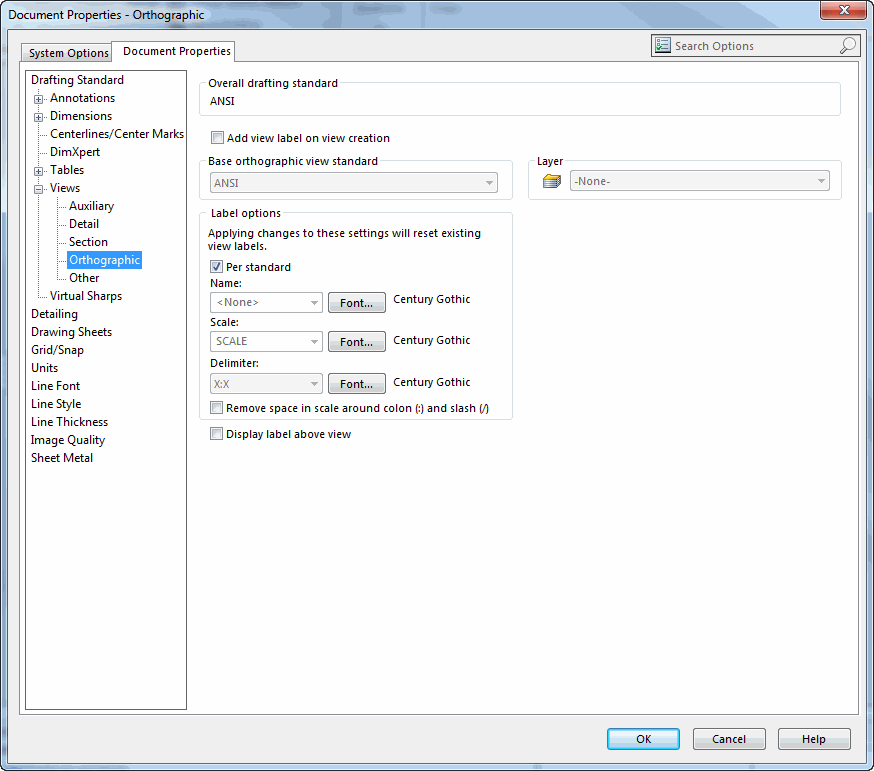

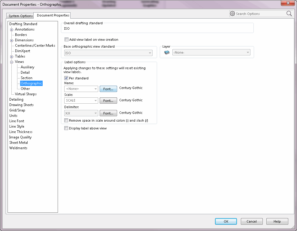

Document Properties > Views > Orthographic
This topic contains two tables. The information in the table:
  • appearing immediately after the screen capture of the Document Properties - Orthographic dialog corresponds to the settings on that dialog.
  • titled Obsolete Enumerators contains enumerators that previously appeared on the Document Properties - Orthographic dialog, but are now obsolete and no longer appear on that dialog.
Setting
Get/Set Methods
Return Value or <Value>
Comments
Add view label on creation
IModelDocExtension::GetUserPreferenceToggle(swUserPreferenceToggle_e.swDetailingOrthoView_AddViewLabelOnViewCreation, swUserPreferenceOption_e.swDetailingNoOptionSpecified)
IModelDocExtension::SetUserPreferenceToggle(swUserPreferenceToggle_e.swDetailingOrthoView_AddViewLabelOnViewCreation, swUserPreferenceOption_e.swDetailingNoOptionSpecified, <Value>)
Boolean value
Specifies whether to add a view label when a view is created
Base orthographic view standard
IModelDocExtension::GetUserPreferenceInteger(swUserPreferenceIntegerValue_e.swDetailingDimensionStandard, swUserPreferenceOption_e.swDetailingOrthoView)
IModelDocExtension::SetUserPreferenceInteger(swUserPreferenceIntegerValue_e.swDetailingDimensionStandard, swUserPreferenceOption_e.swDetailingOrthoView, swDetailingStandard_e.<Value>)
See swDetailingStandard_e for valid options
Specifies the base orthographic view standard to use
Label options - Per standard
IModelDocExtension::GetUserPreferenceToggle(swUserPreferenceToggle_e.swDetailingOrthoViewLabels_PerStandard, swUserPreferenceOption_e.swDetailingNoOptionSpecified)
IModelDocExtension::SetUserPreferenceToggle(swUserPreferenceToggle_e.swDetailingOrthoViewLabels_PerStandard, swUserPreferenceOption_e.swDetailingNoOptionSpecified, <Value>)
Boolean value
If...
Then display the orthographic view label according to the format...
True
Required by the current detailing standard
False
Determined by these document-level user preferences:
swDetailingOrthoView_Name
swDetailingOrthoViewLabels_Scale
swDetailingOrthoViewLabels_Delimiter
Label options - Name
IModelDocExtension::GetUserPreferenceInteger(swUserPreferenceIntegerValue_e.swDetailingOrthoView_Name, swUserPreferenceOption_e.swDetailingNoOptionSpecified)
IModelDocExtension::SetUserPreferenceInteger(swUserPreferenceIntegerValue_e.swDetailingOrthoView_Name, swUserPreferenceOption_e.swDetailingNoOptionSpecified, swDetailingViewLabelsName_e.<Value>)
See swDetailingViewLabelsName_e for valid options
Specifies the label to use in front of the orthographic view; if set to swDetailingViewLabelsName_e.swDetailingViewLabelsName_custom, then set Label options - Name (CUSTOM) to a custom label
IModelDocExtension::GetUserPreferenceString(swUserPreferenceStringValue_e.swDetailingOrthoView_CustomName, swUserPreferenceOption_e.swDetailingSectionView)
IModelDocExtension::SetUserPreferenceString(swUserPreferenceStringValue_e.swDetailingOrthoView_CustomName, swUserPreferenceOption_e.swDetailingSectionView, <Value>)
String value
Specifies the custom label to use in front of the orthographic view; valid only if Label options - Name is set to swDetailingViewLabelsName_e.swDetailingViewLabelsName_custom
Label options - Name - Font
IModelDocExtension::GetUserPreferenceTextFormat(swUserPreferenceTextFormat_e.swDetailingOrthoView_NameTextFormat, swUserPreferenceOption_e.swDetailingNoOptionSpecified)
IModelDocExtension::SetUserPreferenceTextFormat(swUserPreferenceTextFormat_e.swDetailingOrthoView_NameTextFormat, swUserPreferenceOption_e.swDetailingNoOptionSpecified, <Value>)
See ITextFormat for font options
To set font property values, implement ITextFormat, set the appropriate ITextFormat member values, and pass the ITextFormat object in the API set method
Label options - Scale
IModelDocExtension::GetUserPreferenceInteger(swUserPreferenceIntegerValue_e.swDetailingOrthoViewLabels_Scale, swUserPreferenceOption_e.swDetailingNoOptionSpecified)
IModelDocExtension::SetUserPreferenceInteger(swUserPreferenceIntegerValue_e.swDetailingOrthoViewLabels_Scale, swUserPreferenceOption_e.swDetailingNoOptionSpecified, swDetailingViewLabelsScale_e.<Value>)
See swDetailingViewLabelsScale_e for valid options
Specifies the label to use in front of the scale value; if set to swDetailingViewLabelsScale_e.swDetailingViewLabelsScale_SCALEcustom, then set Label options - Scale (CUSTOM) to a custom scale label
IModelDocExtension::GetUserPreferenceString(swUserPreferenceStringValue_e.swDetailingOrthoView_CustomScale, swUserPreferenceOption_e.swDetailingSectionView)
IModelDocExtension::SetUserPreferenceString(swUserPreferenceStringValue_e.swDetailingOrthoView_CustomScale, swUserPreferenceOption_e.swDetailingSectionView, <Value>)
String value
Specifies the custom label to use in front of the scale value; valid only if Label options - Scale is set to swDetailingViewLabelsScale_e.swDetailingViewLabelsScale_SCALEcustom
Label options - Scale - Font
IModelDocExtension::GetUserPreferenceTextFormat(swUserPreferenceTextFormat_e.swDetailingOrthoView_ScaleTextFormat, swUserPreferenceOption_e.swDetailingNoOptionSpecified)
IModelDocExtension::SetUserPreferenceTextFormat(swUserPreferenceTextFormat_e.swDetailingOrthoView_ScaleTextFormat, swUserPreferenceOption_e.swDetailingNoOptionSpecified, <Value>)
Label options - Delimiter
IModelDocExtension::GetUserPreferenceInteger(swUserPreferenceIntegerValue_e.swDetailingOrthoViewLabels_Delimiter, swUserPreferenceOption_e.swDetailingNoOptionSpecified)
IModelDocExtension::SetUserPreferenceInteger(swUserPreferenceIntegerValue_e.swDetailingOrthoViewLabels_Delimiter, swUserPreferenceOption_e.swDetailingNoOptionSpecified, swDetailingViewLabelsDelimiter_e .<Value>)
See swDetailingViewLabelsDelimiter_e for valid options
Specifies the format of the scale value
Label options - Delimiter - Font
IModelDocExtension::GetUserPreferenceTextFormat(swUserPreferenceTextFormat_e.swDetailingOrthoView_DelimiterTextFormat, swUserPreferenceOption_e.swDetailingNoOptionSpecified)
IModelDocExtension::SetUserPreferenceTextFormat(swUserPreferenceTextFormat_e.swDetailingOrthoView_DelimiterTextFormat, swUserPreferenceOption_e.swDetailingNoOptionSpecified, <Value>)
Label options - Remove space in scale around colon (:) and slash (/)
IModelDocExtension::GetUserPreferenceToggle(swUserPreferenceToggle_e.swDetailingOrthoView_RemoveSpaceInScale, swUserPreferenceOption_e.swDetailingNoOptionSpecified)
IModelDocExtension::SetUserPreferenceToggle(swUserPreferenceToggle_e.swDetailingOrthoView_RemoveSpaceInScale, swUserPreferenceOption_e.swDetailingNoOptionSpecified, <Value>)
Boolean value
Specifies whether to remove spaces around the delimiter in the scale text
Display label above view
IModelDocExtension::GetUserPreferenceToggle(swUserPreferenceToggle_e.swDetailingOrthoView_DisplayLabelAboveView, swUserPreferenceOption_e.swDetailingNoOptionSpecified)
IModelDocExtension::SetUserPreferenceToggle(swUserPreferenceToggle_e.swDetailingOrthoView_DisplayLabelAboveView, swUserPreferenceOption_e.swDetailingNoOptionSpecified, <Value>)
Boolean value
Specifies whether to display the label above the orthographic view
Layer
IModelDocExtension::GetUserPreferenceString(swUserPreferenceStringValue_e.swDetailingLayer, swUserPreferenceOption_e.swDetailingOrthoView)
IModelDocExtension::SetUserPreferenceString(swUserPreferenceStringValue_e.swDetailingLayer, swUserPreferenceOption_e.swDetailingOrthoView, <Value>)
Valid Options:
  • "BORDER"
  • "CENTER"
  • "CONTINUOUS"
  • "DIM"
  • "FORMAT"
  • "HIDDEN"
  • "RED"
  • "TEXT"
  • "THIN"
This setting is available only on drawings; depending on drawing, some options may not apply
