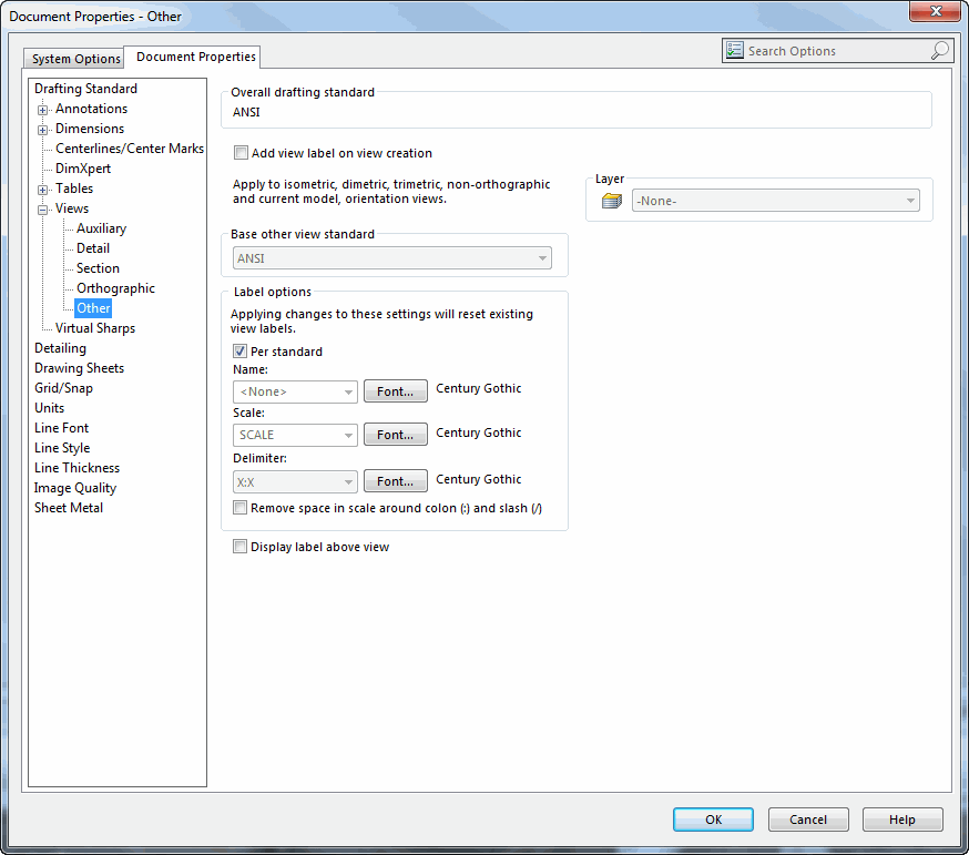

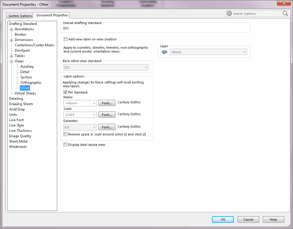

Document Properties > Views > Other
Setting
Get/Set Methods
Return Value or <Value>
Comments
Add view label on view creation
IModelDocExtension::GetUserPreferenceToggle(swUserPreferenceToggle_e.swDetailingMiscView_AddViewLabelOnViewCreation, swUserPreferenceOption_e.swDetailingMiscView)
IModelDocExtension::SetUserPreferenceToggle(swUserPreferenceToggle_e.swDetailingMiscView_AddViewLabelOnViewCreation, swUserPreferenceOption_e.swDetailingMiscView, <Value>)
Boolean value
Specifies whether to add a view label when the view is created
Base other view standard
IModelDocExtension::GetUserPreferenceInteger(swUserPreferenceIntegerValue_e.swDetailingDimensionStandard, swUserPreferenceOption_e.swDetailingMiscView)
IModelDocExtension::SetUserPreferenceInteger(swUserPreferenceIntegerValue_e.swDetailingDimensionStandard, swUserPreferenceOption_e.swDetailingMiscView, swDetailingStandard_e.<Value>)
See swDetailingStandard_e for valid options
Specifies the base miscellaneous view standard to use
Label options - Per standard
IModelDocExtension::GetUserPreferenceToggle(swUserPreferenceToggle_e.swDetailingMiscView_PerStandard, swUserPreferenceOption_e.swDetailingMiscView)
IModelDocExtension::SetUserPreferenceToggle(swUserPreferenceToggle_e.swDetailingMiscView_PerStandard, swUserPreferenceOption_e.swDetailingMiscView, <Value>)
Boolean value
If...
Then display the miscellaneous view label according to the format...
True
Required by the current detailing standard
False
Determined by these document-level user preferences:
swDetailingMiscView_Name
swDetailingMiscView_Scale
swDetailingMiscView_Delimiter
Label options - Name
IModelDocExtension::GetUserPreferenceInteger(swUserPreferenceIntegerValue_e.swDetailingMiscView_Name, swUserPreferenceOption_e.swDetailingMiscView)
IModelDocExtension::SetUserPreferenceInteger(swUserPreferenceIntegerValue_e.swDetailingMiscView_Name, swUserPreferenceOption_e.swDetailingMiscView, swDetailingViewLabelsName_e.<Value>)
See swDetailingViewLabelsName_e for valid options
Specifies the label to use in front of the miscellaneous view; if set to swDetailingViewLabelsName_e.swDetailingViewLabelsName_custom, then set Label options - Name (CUSTOM) to a custom label
IModelDocExtension::GetUserPreferenceString(swUserPreferenceStringValue_e.swDetailingMiscView_CustomName, swUserPreferenceOption_e.swDetailingSectionView)
IModelDocExtension::SetUserPreferenceString(swUserPreferenceStringValue_e.swDetailingMiscView_CustomName, swUserPreferenceOption_e.swDetailingMiscView, <Value>)
String value
Specifies the custom label to use in front of the miscellaneous view; valid only if Label options - Name is set to swDetailingViewLabelsName_e.swDetailingViewLabelsName_custom
Label options - Name - Font
IModelDocExtension::GetUserPreferenceTextFormat(swUserPreferenceTextFormat_e.swDetailingMiscView_NameTextFormat, swUserPreferenceOption_e.swDetailingMiscView)
IModelDocExtension::SetUserPreferenceTextFormat(swUserPreferenceTextFormat_e.swDetailingMiscView_NameTextFormat, swUserPreferenceOption_e.swDetailingMiscView, <Value>)
See ITextFormat for font options
To set font property values, implement ITextFormat, set the appropriate ITextFormat member values, and pass the ITextFormat object in the set method
Label options - Scale
IModelDocExtension::GetUserPreferenceInteger(swUserPreferenceIntegerValue_e.swDetailingMiscView_Scale, swUserPreferenceOption_e.swDetailingMiscView)
IModelDocExtension::SetUserPreferenceInteger(swUserPreferenceIntegerValue_e.swDetailingMiscView_Scale, swUserPreferenceOption_e.swDetailingMiscView, swDetailingViewLabelsScale_e.<Value>)
See swDetailingViewLabelsScale_e for valid options
Specifies the label to use in front of the scale value; if set to swDetailingViewLabelsScale_e.swDetailingViewLabelsScale_SCALEcustom, then set Label options - Scale (CUSTOM) to a custom scale label
IModelDocExtension::GetUserPreferenceString(swUserPreferenceStringValue_e.swDetailingMiscView_CustomScale, swUserPreferenceOption_e.swDetailingMiscView)
IModelDocExtension::SetUserPreferenceString(swUserPreferenceStringValue_e.swDetailingMiscView_CustomScale, swUserPreferenceOption_e.swDetailingMiscView, <Value>)
String value
Specifies the custom label to use in front of the scale value; valid only if Label options - Scale is set to swDetailingViewLabelsScale_e.swDetailingViewLabelsScale_SCALEcustom
Label options - Scale - Font
IModelDocExtension::GetUserPreferenceTextFormat(swUserPreferenceTextFormat_e.swDetailingMiscView_ScaleTextFormat, swUserPreferenceOption_e.swDetailingMiscView)
IModelDocExtension::SetUserPreferenceTextFormat(swUserPreferenceTextFormat_e.swDetailingMiscView_ScaleTextFormat, swUserPreferenceOption_e.swDetailingMiscView, <Value>)
Label options - Delimiter
IModelDocExtension::GetUserPreferenceInteger(swUserPreferenceIntegerValue_e.swDetailingMiscView_Delimiter, swUserPreferenceOption_e.swDetailingMiscView)
IModelDocExtension::SetUserPreferenceInteger(swUserPreferenceIntegerValue_e.swDetailingMiscView_Delimiter, swUserPreferenceOption_e.swDetailingMiscView, swDetailingViewLabelsDelimiter_e .<Value>)
See swDetailingViewLabelsDelimiter_e for valid options
Specifies the format of the scale value
Label options -  Delimiter - Font
IModelDocExtension::GetUserPreferenceTextFormat(swUserPreferenceTextFormat_e.swDetailingMiscView_DelimiterTextFormat, swUserPreferenceOption_e.swDetailingMiscView)
IModelDocExtension::SetUserPreferenceTextFormat(swUserPreferenceTextFormat_e.swDetailingMiscView_DelimiterTextFormat, swUserPreferenceOption_e.swDetailingMiscView, <Value>)
Label options - Remove space in scale around colon (:) and slash (/)
IModelDocExtension::GetUserPreferenceToggle(swUserPreferenceToggle_e.swDetailingMiscView_RemoveSpaceInScale, swUserPreferenceOption_e.swDetailingMiscView)
IModelDocExtension::SetUserPreferenceToggle(swUserPreferenceToggle_e.swDetailingMiscView_RemoveSpaceInScale, swUserPreferenceOption_e.swDetailingMiscView, <Value>)
Boolean value
Specifies whether to remove extra spaces around the delimiter in the scale text
Display label above view
IModelDocExtension::GetUserPreferenceToggle(swUserPreferenceToggle_e.swDetailingMiscView_DisplayLabelAboveView, swUserPreferenceOption_e.swDetailingMiscView)
IModelDocExtension::SetUserPreferenceToggle(swUserPreferenceToggle_e.swDetailingMiscView_DisplayLabelAboveView, swUserPreferenceOption_e.swDetailingMiscView, <Value>)
Boolean value
Specifies whether to show the label above the miscellaneous view
Layer
IModelDocExtension::GetUserPreferenceString(swUserPreferenceStringValue_e.swDetailingLayer, swUserPreferenceOption_e.swDetailingMiscView)
IModelDocExtension::SetUserPreferenceString(swUserPreferenceStringValue_e.swDetailingLayer, swUserPreferenceOption_e.swDetailingMiscView, <Value>)
Valid Options:
  • "Border"
  • "Dimensions"
  • "Notes"
  • "BOM"
  • "FORMAT"
This setting is available only on drawings; depending on the drawing, some options may not apply
