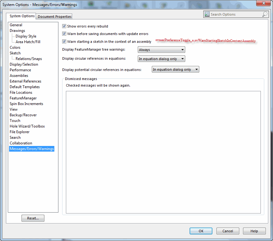

System Options > Messages/Errors/Warnings
Setting
Get/Set Methods
Return Value or <Value>
Comment
Show errors every rebuild
ISldWorks::GetUserPreferenceToggle(swUserPreferenceToggle_e.swShowErrorsEveryRebuild)
ISldWorks::SetUserPreferenceToggle(swUserPreferenceToggle_e.swShowErrorsEveryRebuild, <Value>)
Boolean value
Specifies whether to display error dialogs when rebuilding models with errors
Warn before saving documents with update errors
ISldWorks::GetUserPreferenceToggle(swUserPreferenceToggle_e.swWarnSaveUpdateErrors)
ISldWorks::SetUserPreferenceToggle(swUserPreferenceToggle_e.swWarnSaveUpdateErrors, <Value>)
Boolean value
Specifies whether to display a warning before saving documents with update errors
Warn starting a sketch in the context of an assembly
ISldWorks::GetUserPreferenceToggle(swUserPreferenceToggle_e.swWarnStartingSketchInContextAssembly)
ISldWorks::SetUserPreferenceToggle(swUserPreferenceToggle_e.swWarnStartingSketchInContextAssembly, <Value>)
Boolean value
Specifies whether to display a warning before starting a sketch in the context of an assembly
Display FeatureManager tree warnings
ISldWorks::GetUserPreferenceIntegerValue(swUserPreferenceIntegerValue_e.swFeatureManagerDisplayWarnings)
ISldWorks::SetUserPreferenceIntegerValue(swUserPreferenceIntegerValue_e.swFeatureManagerDisplayWarnings, swFeatureManagerDisplayWarnings_e.<Value>)
See swFeatureManagerDisplayWarnings_e for valid options
Specifies when to display FeatureManager design tree warnings
Display circular references in equations
ISldWorks::GetUserPreferenceIntegerValue(swUserPreferenceIntegerValue_e.swShowEquationCircularReferencesMessage)
ISldWorks::SetUserPreferenceIntegerValue(swUserPreferenceIntegerValue_e.swShowEquationCircularReferencesMessage, swDisplayCircularReferencesInEquations_e.<Value>)
See swDisplayCircularReferencesInEquations_e for valid options
Specifies where, or if, to display circular references in equations
Display potential circular references in equations
ISldWorks::GetUserPreferenceIntegerValue(swUserPreferenceIntegerValue_e.swShowEquationPotentialCircularReferencesMessage)
ISldWorks::SetUserPreferenceIntegerValue(swUserPreferenceIntegerValue_e.swShowEquationPotentialCircularReferencesMessage, swDisplayPotentialCircularReferencesInEquations_e.<Value>)
See swDisplayPotentialCircularReferencesInEquations_e for valid options
Specifies where, or if, to display potential circular references in equations
Dismissed messages - Checked message will be shown again.
See Comment
See Comment
Not currently supported in SolidWorks API
