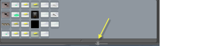

To view the Network Monitor Pane, with the Final Render Window:
  1. Look for the dark gray strip with a small group of tiny squares at the very bottom of the Final Render Window.
  2. Mouse over the strip until your pointer changes to what's shown below.
  3. Drag up to reveal the Network Monitor Pane.
