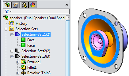

You can select multiple entities in a model or drawing and save the selections as a selection set that you can return to at any time.
When you create a selection set, it is saved in the Selection Sets
folder in the FeatureManager design tree.
Automatic display of the Selection Sets
folder is enabled in under Hide/show tree items.
